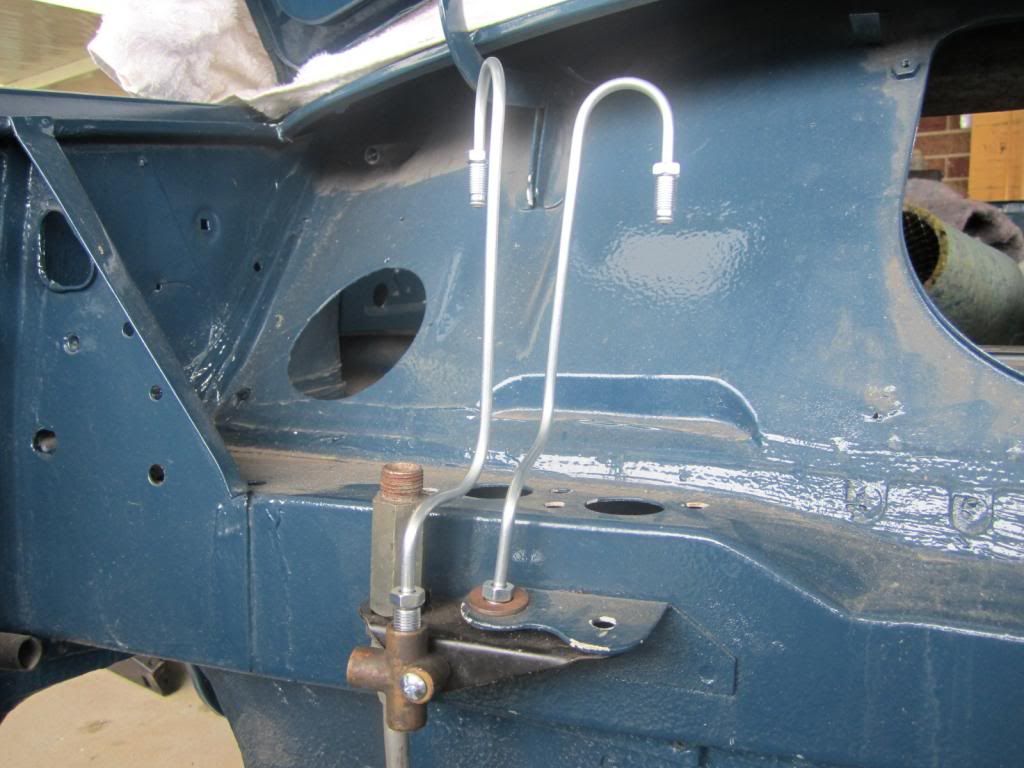

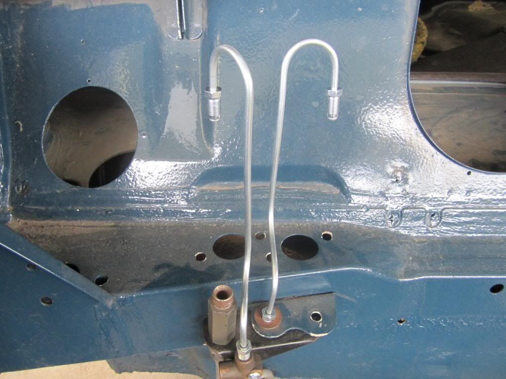

Hi Super Cooper
I think the brake reservoir is closest to the bulk head
and the clutch to the front
your clutch pipe will have a 90 deg side step and the brake pipe will
be 45 deg in the opposite direction
I will try to post a picture for you
Mark
 Post subject: Re: Master cylinders
PostPosted: Sun Mar 23, 2014 2:53 pm
Posts: 850
Location: Narellan NSW
Hope this help

Thanks Slacko! Went thru some tme mags last night too and most pics seem to be brake reservoir closest to bulkhead.
Have not yet tried the wire method as yet. Just got home from work.
Will hopefully get some time when the monsters go to bed.
Thanks all for the posts.

Also looking at the Photo with the master cylinders fitted.
and the Doc may be better able to advise You, But it is my opinion
that the pipes fitted in that photo are incorrect as in not the correct bends
in the correct places
I am however not saying they will not work as they are.
Thanks John. Now that you point it out those pipes do look wrong. I have not touched that car (mini k)
But someone has. As Slacko also posted the pipes sought of reveal the orientation.
Cheers.
