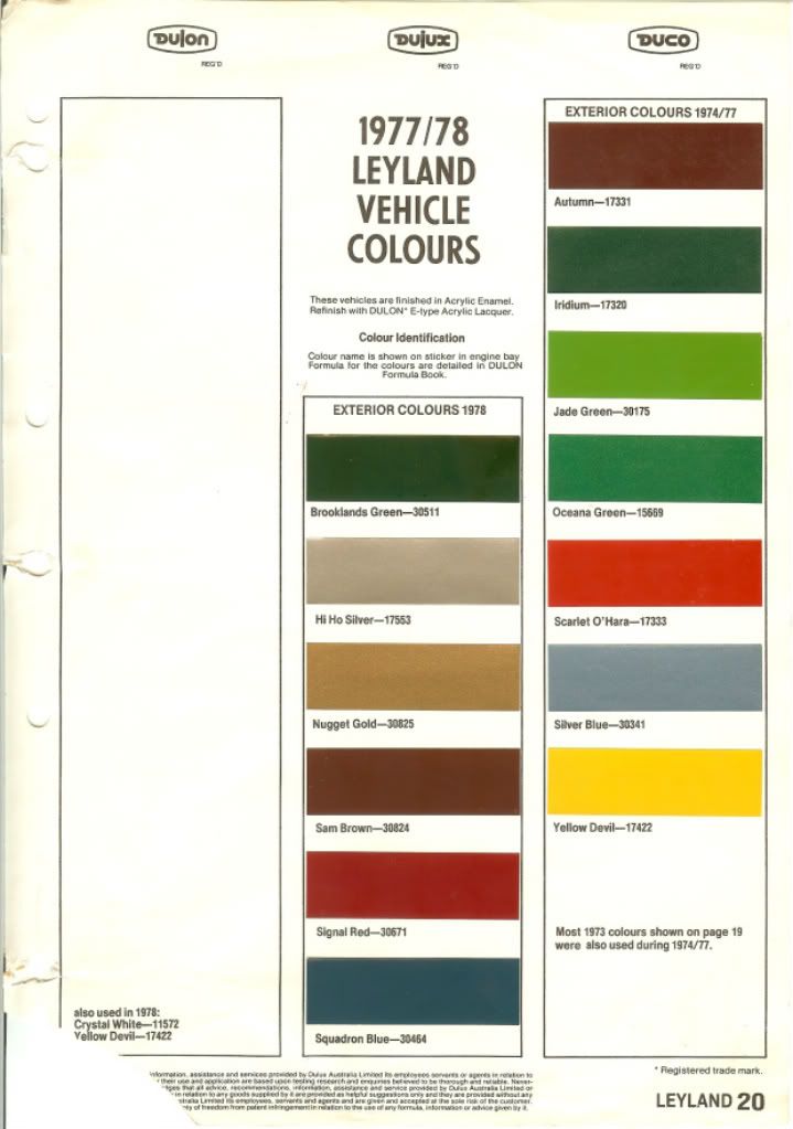

It's probably one of these. Is that the original green paint behind the ADR compliance plate in your photo?

The vehicle has been resprayed at least once and I am unsure whether it is original colour or not.
Thanks for the reply, my mini is a 76 model and I can't find a way to link the chassis plate with any paint codes I've found.

My guess is country cream, which is a 75 colour but who knows right?

Neuthirteen wrote:
Ahh thanks that clears that up, so is there a way of finding original colour?
There are no records showing the original build colour of your car. As others have said, you need to do some detective work on the car itself. If it was completely stripped back to bare metal and painted at some stage then you really have no way of knowing. But cars are often re-sprayed over the top of the previous colour, or are not re-sprayed in areas that are not usually seen or are difficult to get to.
A few suggestions:
1. Remove interior trim and check what colour paint is revealed.
2. Look under the front and back parcel shelves, and under the scuttle (the panel across and under the windscreen).
3. Carefully peel back the headlining to reveal bodywork.
4. Remove paint with a solvent (in a hidden spot) to see what different layers there are underneath.
5. Ignore what colour it was originally and choose something you like.

http://www.classicmotoring.net.au/cmos/ ... e&pID=1430
Its on a sticker like this it just says the colour

Our 76 clubby S had a foil sticker that looked exactly like this:
It was located near the compliance plate. Have a hunt around the engine bay, it might have just been painted over?
