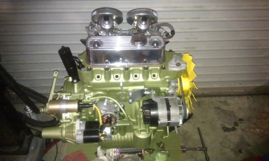

Morris 1100 had two Morris Minor mounts attached to a plate behind the timing cover, one front one back.
You can see the front one just under the alternator, just.
Ash.
