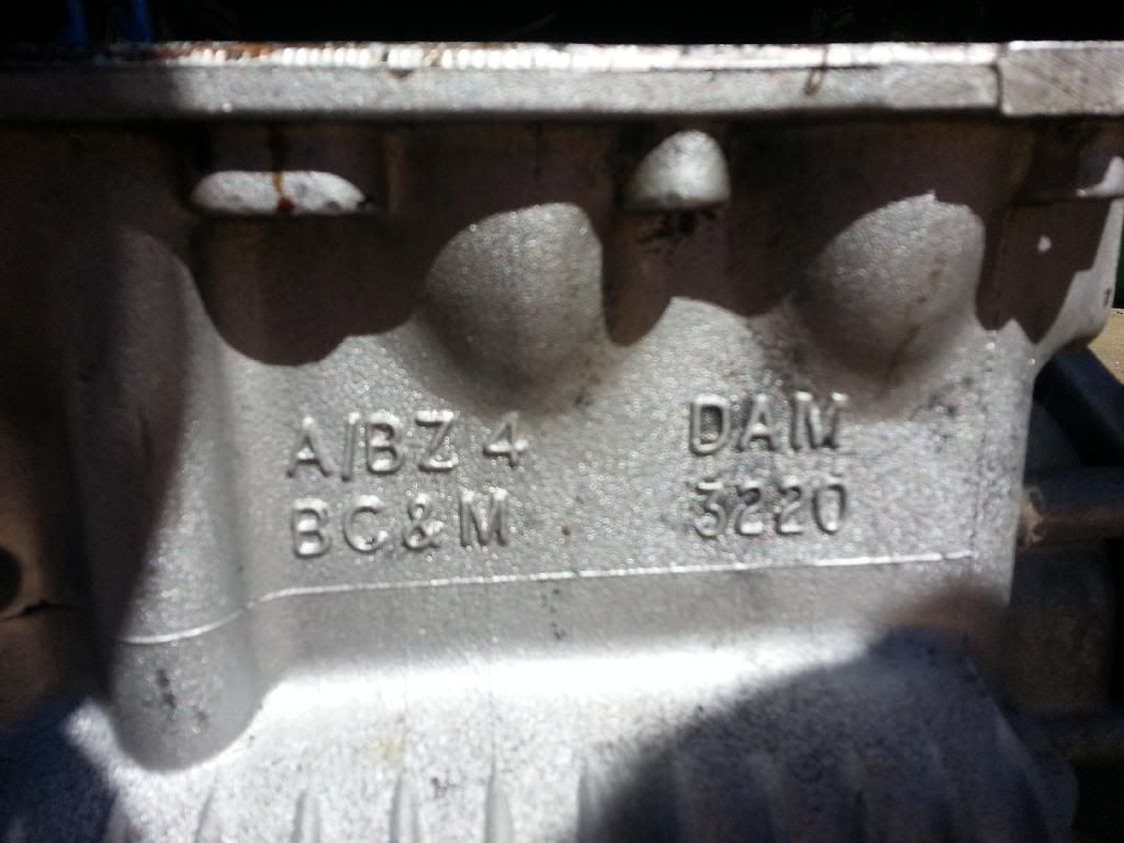

Gearbox #1 - This one looks to have the better synchros...
A/BZ4
BC&M
DAM3220

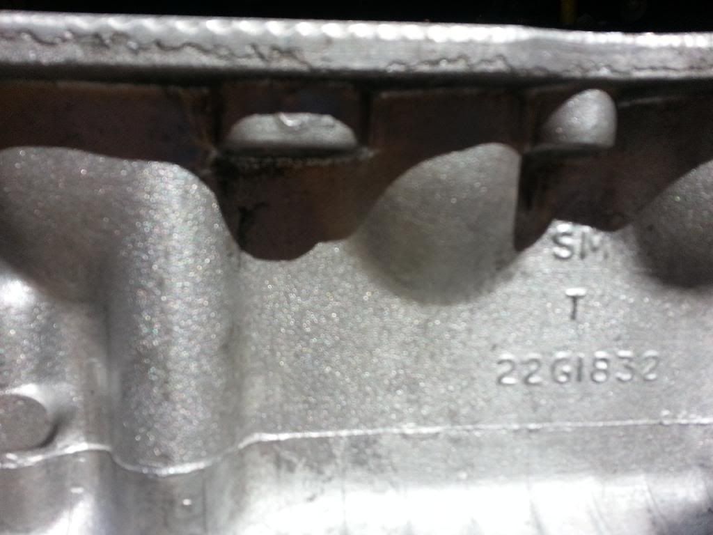

Gearbox #2
SM
T
22G1832

1st one according to Mini King book is rodchange with small idler bearing,
2nd one is a more common Oz rodchange, small idler bearing, same ratios as a Mini K etc remote box.
Essentially both boxes are much the same if my books are right.
