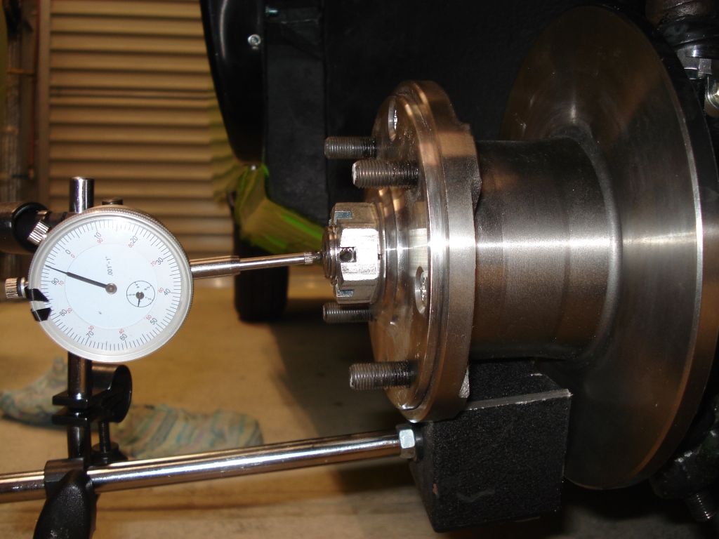

My front wheels still wobble slightly in a 360 degrees radius when turned by hand and I'm now certain it's the bearings.
I've locked up the ball joints and steering track rod to check and it's definitely the bearings.

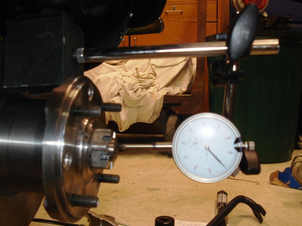

What I am not so sure of is how to use a dial indicator to check the end play.
I've basically stuck the magnetic end on the disc rotor and the needle on the end of the CV and rotated the rotor 360 degrees whilst "pulling" and "pushing".

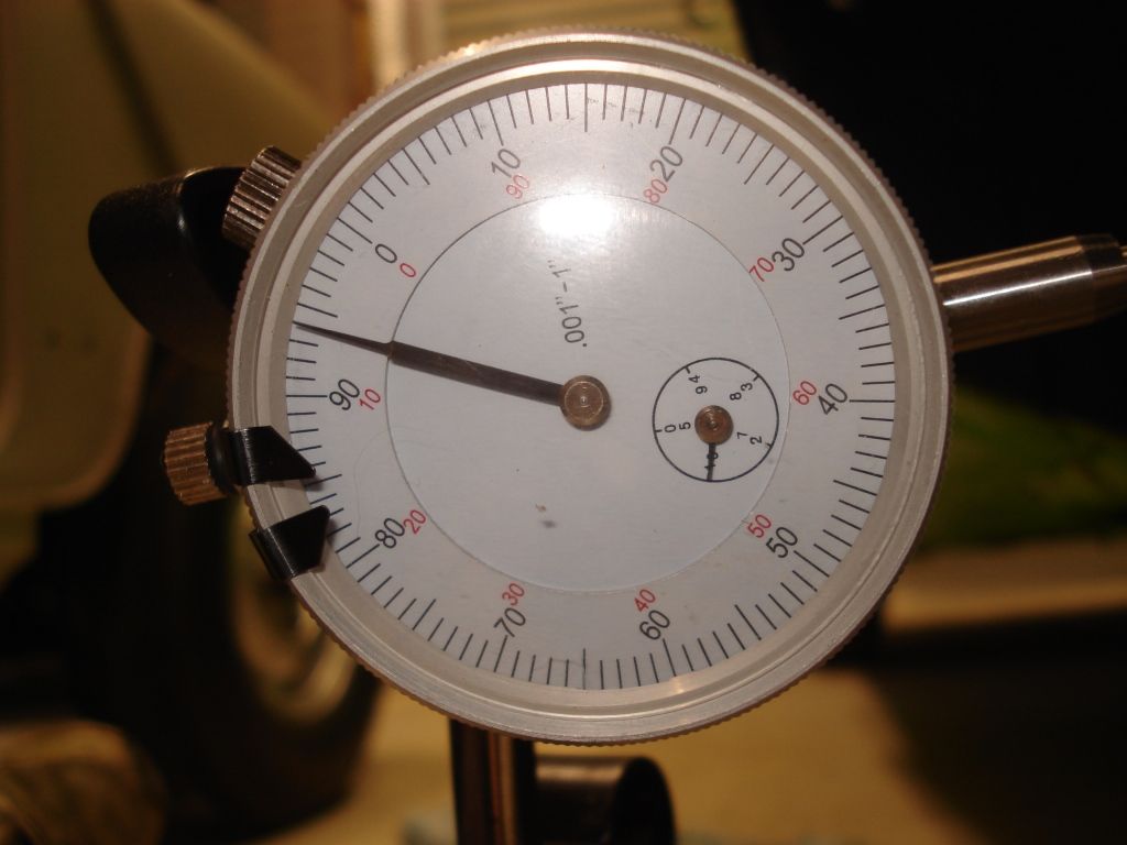

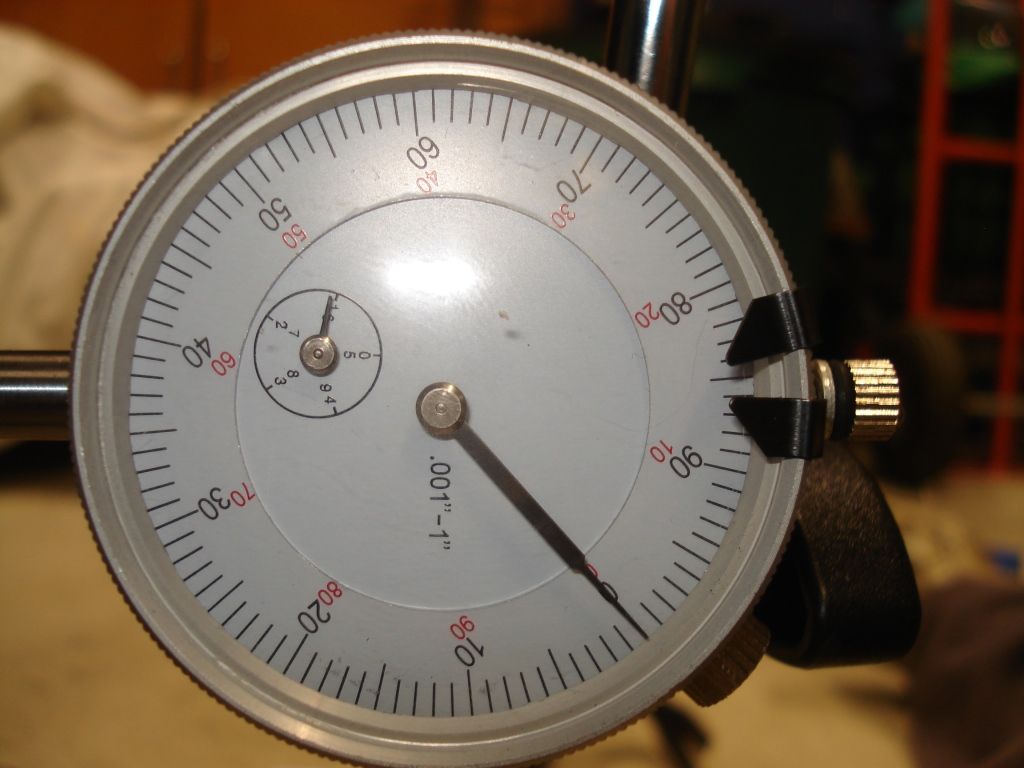

I get two readings, one where the dial doesn't move which I've set to 0 and the other 6 thou (0 is at the start point and the 6 thou reading is when the rotor is turned 180 degrees).
These are minimum and maximum readings when the rotor is turned a complete 360 degrees whilst pushing and pulling.
My question then is this-does this mean the bearing end play is 6 thou in total so I need to machine off 7 thou off the spacer to allow for a 1 thou bearing preload?.
Here is a couple of photos of the situation:
Minimum reading (dial at the top) = 0
Maximum reading (when rotor is turned 180 degrees)= 6 thou
Any advice would be great as I don't want to stuff this up
Thanks
Dave

What you are doing there is not right at all.
Firstly, if the cv joint is done up tight, the rotor will move with the cv joint as they are bolted together. If there was play in the bearing then the whole assembly (the rotor, cv joint and the bearings) would all move together and the play would be between the inner and outer bearing races inside the hub. If there is play between the rotor and the cv joint then the cv joint is loose.
Also, how have you locked up the balljoints and tie rod end?
Just going off your pictures, it doesn't look like the cv joint is done up tight, the split collar doesn't look like it's squeezed up enough.
My suggestion would be to do the cv joint nut up firmly by hand and check the feel of spinning the wheel. Try to get an idea of the rolling resistance of the bearing and assembly.
Then do it up to 150ft/lb then continue to the next split pin hole and check for any play in the assembly. If there is no play and the rolling resistance has not increased then it should be all good to go.
If there is still play then you need a thinner spacer, if the rolling resistance has increased then either the disc is rubbing on the steering arm or the hub or the bearing is too tight and you need a bigger spacer.
