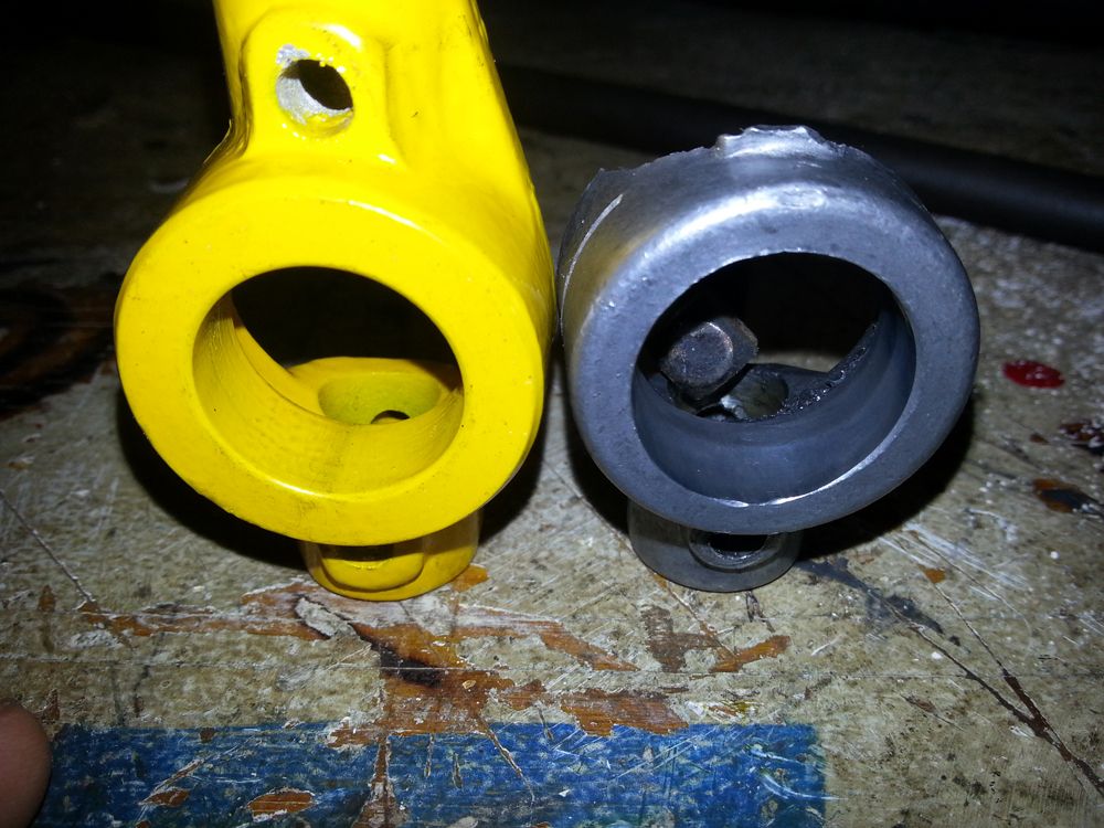

PostPosted: Mon Apr 07, 2014 8:27 pm
Posts: 307
Location: East Melbourne
I found that alot of the slop in my gearstick went away when i replaced the saddle/cup. They are made out of aluminum so i think it would wear a lot faster than the ball on the end of the gearstick.
You can see here how much it was worn:
PostPosted: Thu Apr 10, 2014 5:42 pm
Joined: Sat Apr 30, 2011 7:18 am
Posts: 110
Location: Gold Coast
Thanks for the pic. I think I will pull it apart soon and renew the saddle. Seeing how worn it can get i think it would make it a lot smoother and nicer.
