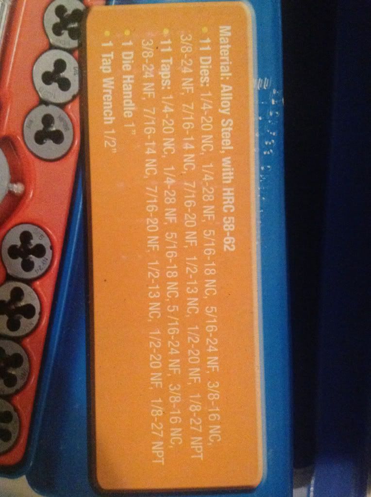

Based on advise I made this purchase today :D
Made by Kincrome its a 24 pieces set I guess it's a good start! Also brought myself some big arse spanners 8)

I hate to sound anal but I have only ever used ISO recognised type brands like P&N or Sutton etc
It's easy once you know how.
Great advise thank you. I just picked up a cheaper set to start off with if I start using it a lot I'll upgrade as required. I do like Sutton drill bits :D
 Post subject: Re: Tap & Die Set
PostPosted: Tue Apr 08, 2014 8:59 am
Posts: 39757
Same here, recognised brand (eg P&N, Sutton, etc) taps and dies are thread ground to size after heat treatment, and made from quality tool steel or HSS. The el cheapo ones are not.
