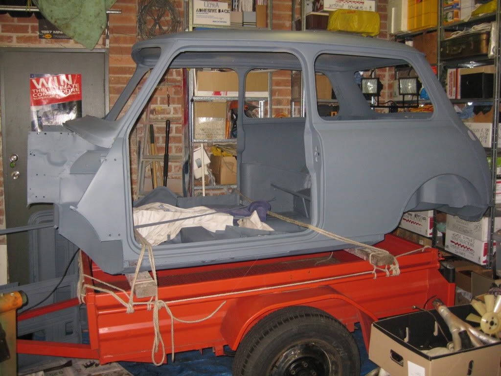

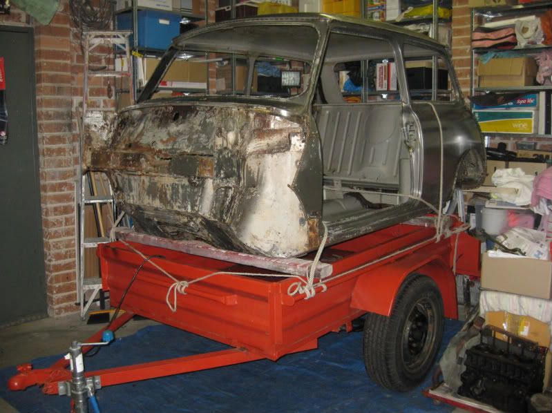

You do need to make sure that the Sandblasting company knows what they are doing and how to treat blasting of a car without causing any damage . I have had a few minis blasted but only after I have chemically stripped the paint and have then asked for the edges of panels only to be blasted. Also note they don't use sand but Garnet.
Once the car has been blasted it is then necessary to make sure all of the sand is cleaned and removed from all of the crevices otherwise it will come out at the time of painting. :(
Here is one I prepared earlier, before and after
I definitely think that having a body shell blasted is much better to remove rust than any other method but do your research first.
Good luck
