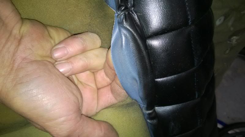

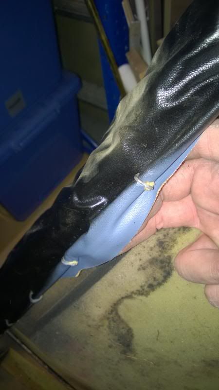

Just started stripping my car down for a restoration. It is an Indigo Blue 68 S. The interior is all black and I thought that's what it was supposed to be until I pulled the seats out and discovered they have been sprayed black.

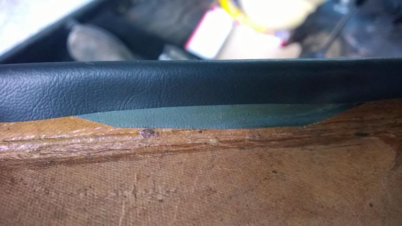

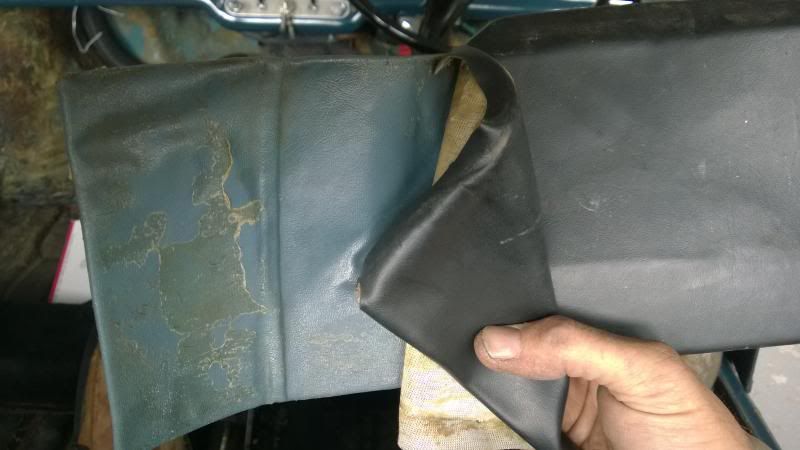

So it looks like it should be blue! Then when I took the rear bin lining out I noticed there were two layers of vinyl.
So I peeled back the top layer to reveal what must be the correct colour interior for my car.
