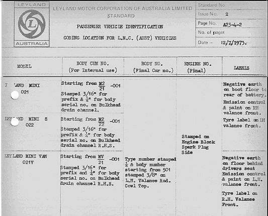

There is often discussion about the location, font size and content of various stampings and labelling on the Mini body done during the production process. Below is a section of the relevant page from the LMCA Standards Manual that describes these for Clubman bodies. The measurements are in inches. You'll see the body prefix is stamped in 1/4" font and the body number in 3/8" font on the radiator shroud.
