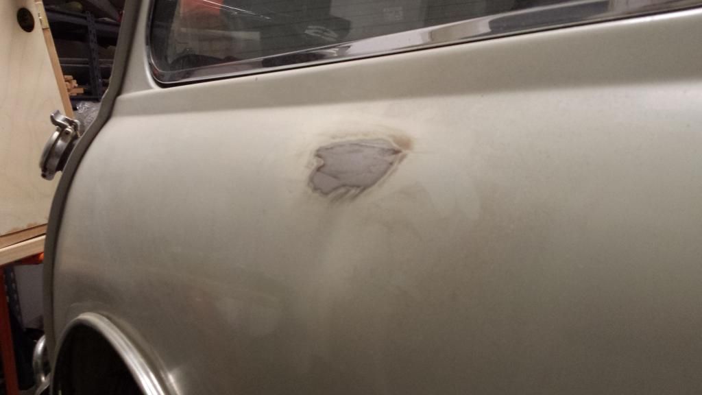

I've got a bit of paint missing from the rear drivers quarter. Its the result of a bump during the previous owners stewardship when the car was stolen for a year and recovered :lol:
Now I want to remove the bumps from the panel, and respray the area.
I can weld, and I can paint a little, but ripples are not my strength.
Anyway, I've buffed the paint back, to get rid of the fractured paint and surface rust.
Part of the buffed area has light ripples, but the paint below you may see in the image has a larger ripple. There's no creases thankfully.
How does one approach a job like this?

I'd have assumed it was a body filler and wide flat sander job?
is it just the photo, or does it have a flat spot around the wheel arch too? I'd love to know how to fix those....

Its just paint over a once-flat panel. The ripple has happened after at some time. Whatever hit the car was soft.
There's no flat spot luckily around the arch. The paint was hidden by an arch which is now removed and the paint was less weathered behind it.

Hey mick just been through this with my deluxe. The problem you have is the metal has stretched and needs to be re shrunk.
There is a few options
heat shrink the area. Heat until cherry red then quench. Have to be good which im not.
use a shrinking hammer and dolly but will still have ripples just smaller ones.
And one I have just found out about but not tried is a stainless steel shrinking disc on the grinder. It supposably works really well but I havent tried yet.
probly havent helped you much but there is a few idead for you too look at.

I'm going through a few options online. Most use presses and dollies to massage the metal out. I have half a mind to start here, and move onto using heat from a butane bottle like you recommend above. I'm keen not to cause as many ripples as I remove however. Luckily where it is means I have open access to the other side.

Have a look for the stainless shrinking discs. Meant to be the best thing

re the heat shrinking, you can do this with a carbon electrode + bracket, held in the MIG torch. More repeatable than using a gas torch.
I made one up for Simon K a while back, and gave him 1/2 my carbon too.

One thing to keep in mind you could start chasing it when you hot shrink I would use a slapper and dolly first before I put heat on it

I've gone at it with the curved dollies from behind, just held it in my palm and used the dolly so it matches the curve of the panel and it seems to have removed most of the ripples straight up..I might have over analyzed this...
I'm going to give it a few coats of spray putty and see how the panel sands up. I'll put some images up soon.
