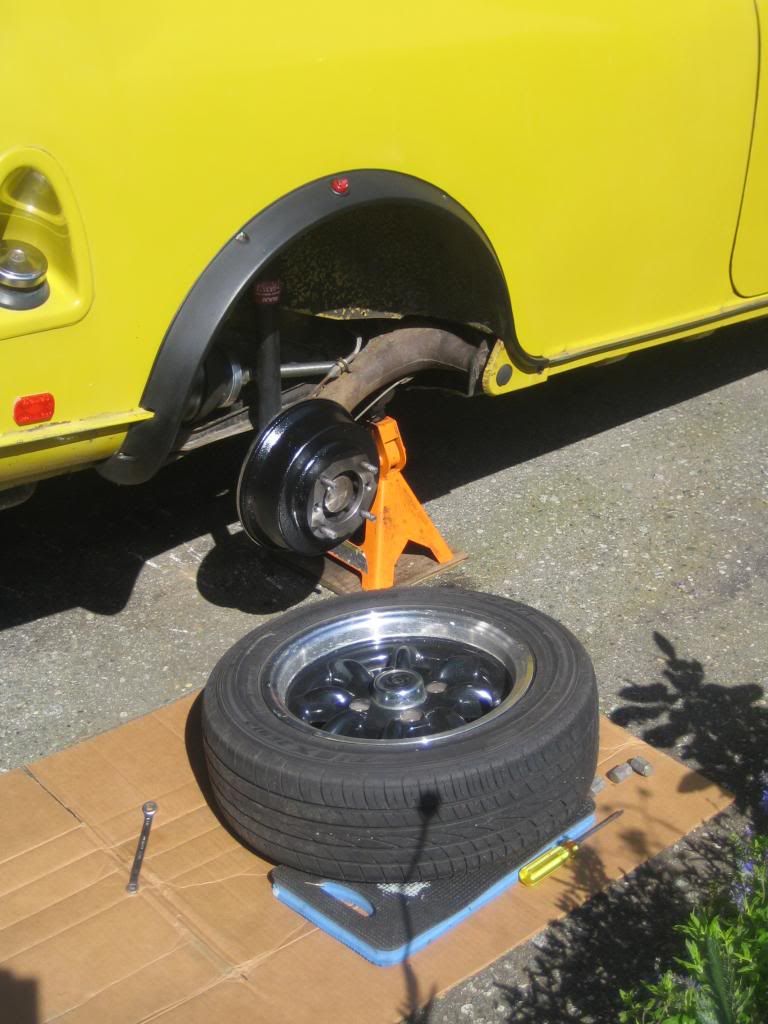

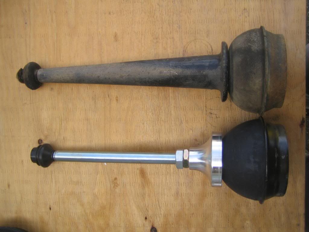

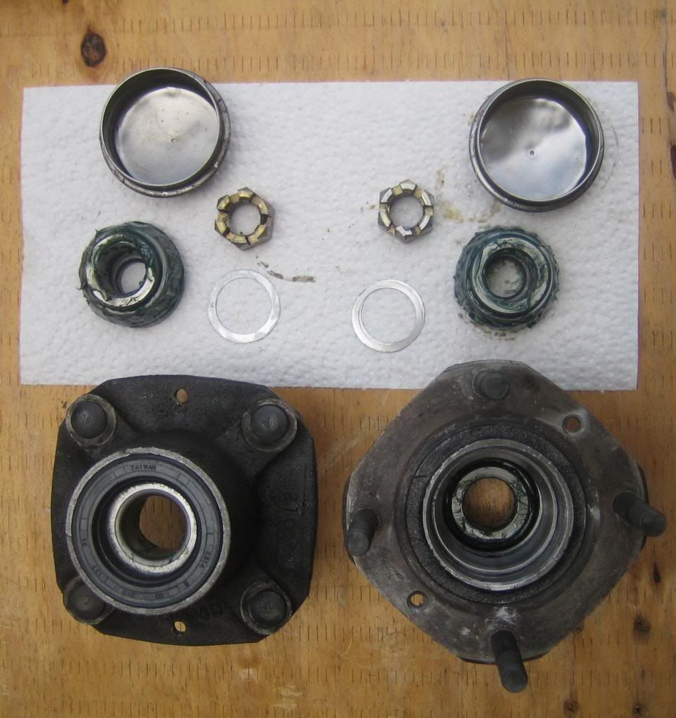

Have finished the work on ROO's rear, except camber set when alignment is done. New knuckles, new wheel studs, bearings repacked, new S drums (replacing non-spacered stock items), new rubber doughnuts/springs, new adjustable trumpets...

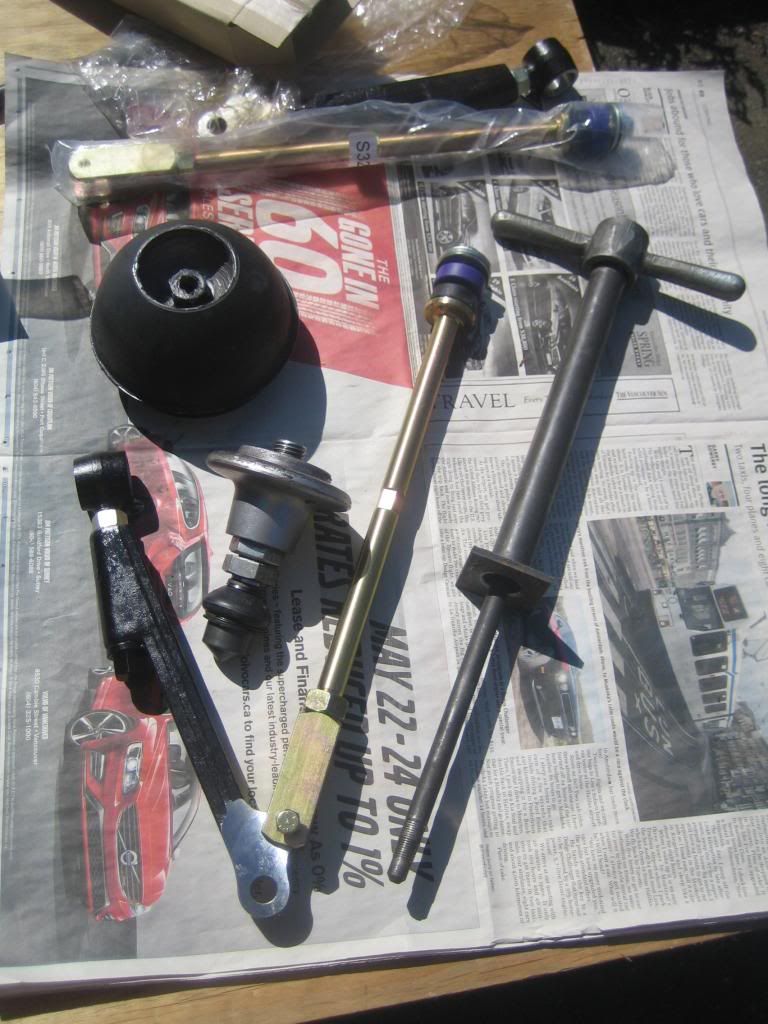

Halfway through the front...getting new knuckles, new rubber doughnuts/springs, new adjustable lower arms and new adjustable tie-rods going together with the then new adjustable trumpets and new Koni dampers added in Ermington & North Rocks, NSW in 2011...
