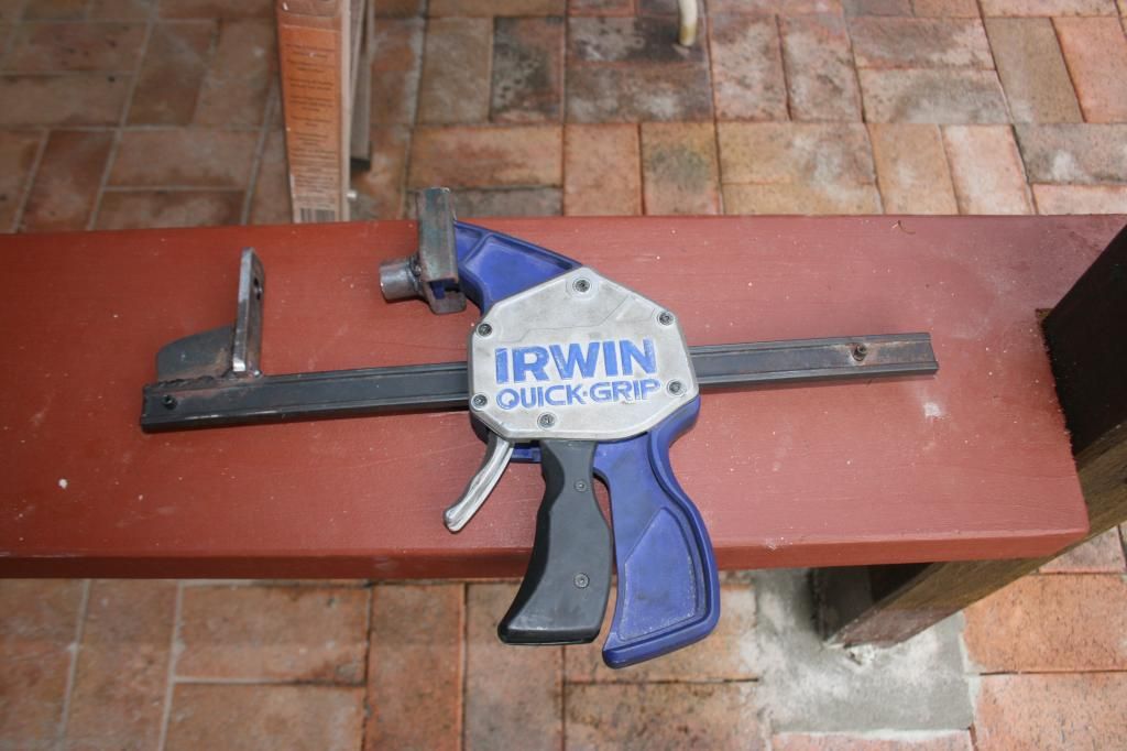

I made my own valve spring compressor
I used one of those Irwin quick grip clamps……one that is a cross between a f clamp and a silicone gun….. :D
I welded a bit of flat bar with a hole drilled in it to the end that pulls the spring down.
The hole is just a little larger than the collets…..and at the other end just made a sleeve with a bit of tubing that is long enough to sit against the valve.
The great thing about this valve spring compressor is that you only need one hand to use it……plus it pulls in slow increments
So you have time to play and adjust the spring and line things up…..
don’t ask me how much the clamp cost…….I borrowed from work……funny the boss still asks if any one has seen his clamp…….three years on…. :roll:
cheers Neil

This is brilliant. Add it to the project list!

Nice :)

Nice and simple engineering. Well done.
