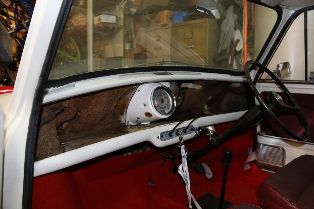

I have a mini that has had the Dash and Parcel Shelf sprayed in Satin Black which I have started removing.
The Satin Black top coat comes off with General Purpose thinners (Septone).
The Grey Primer is not affected by the Thinners but comes off with Acetone.
I have no started cleaning both layers of paint off with the Acetone.
What I'm surprised by is that the original Nurburg White does not seem to be affected by the Acetone.
Can anyone explain why.

Spent a few hours cleaning all the Satin Black off and the primer.
Back to original finish. Looks much better.
What colour should the switch panel be ?
It,s currently grey primer.
