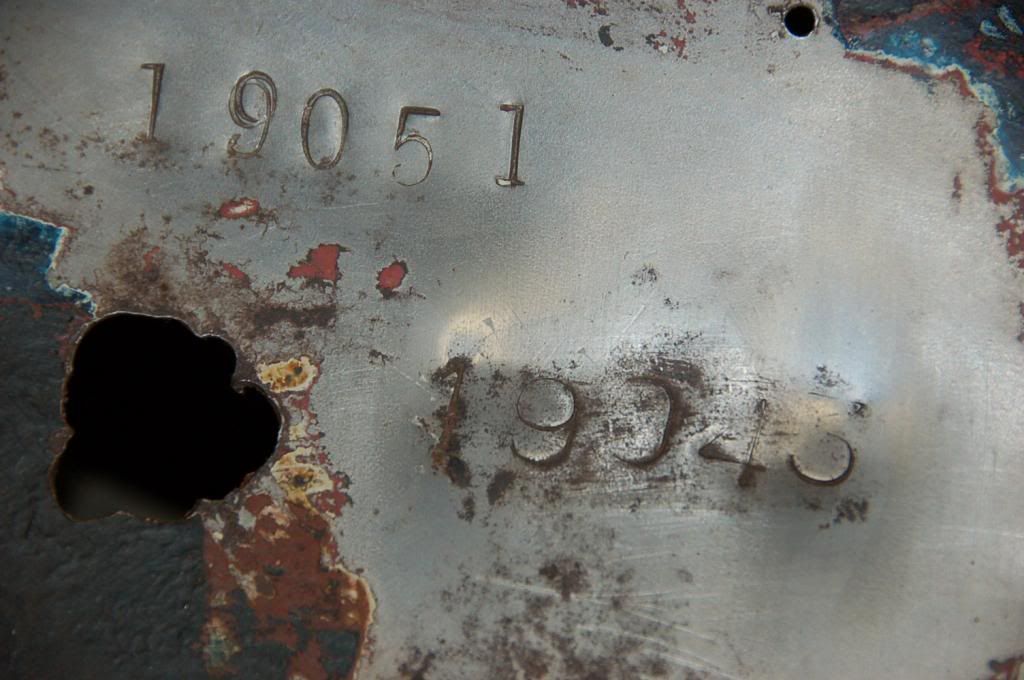

Wow, full points to Morris1100, you can see here why I couldn't see any numbers there, 50 years of brake fluid has eaten the steel in that area
But I got behind it and scrubbed off all that shitty contact adhesive and look what I saw!
Amazing, why would they have two sets of numbers, I guess the did a recount and couldn't find the other 61 cars in Australia, the boat must have sunk

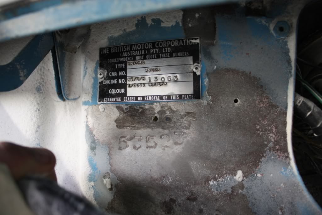

Mine had something similar. But the higher number was ground back .Image

The number that is behind the ID plate is the body number. It was stamped before the body was painted.
The number below the ID plate is the car number, it is stamped when the car is assembled and is stamped through the paint, this is why it rusts so easily!
Your car is perfectly normal, all Minis have two sets of numbers. (well four sets of numbers if you really want to get picky)
They moved the locations of the numbers around on different models.

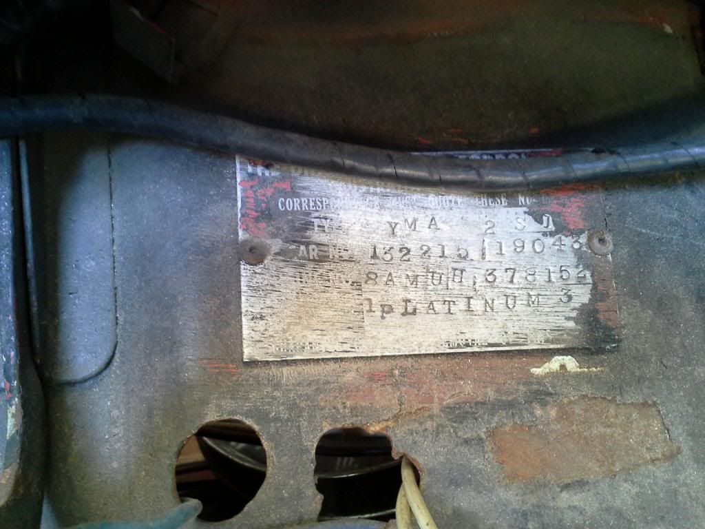

Bit of a thread hijack, but do the stampings in the following photo look original for a 1962 850?
The car also has the small plate over the holes to mount the accelerator pedal. Same as that in andrew9's photo.
PostPosted: Fri May 02, 2014 5:37 pm
That looks pretty normal to me.
Notice that the top number is very clean because it was painted after it was stamped and the bottom one is pitted because they knocked the paint off with the stamps.
Another thing that is worth a mention is the differences in the fonts between the body plant and the assembly plant.
