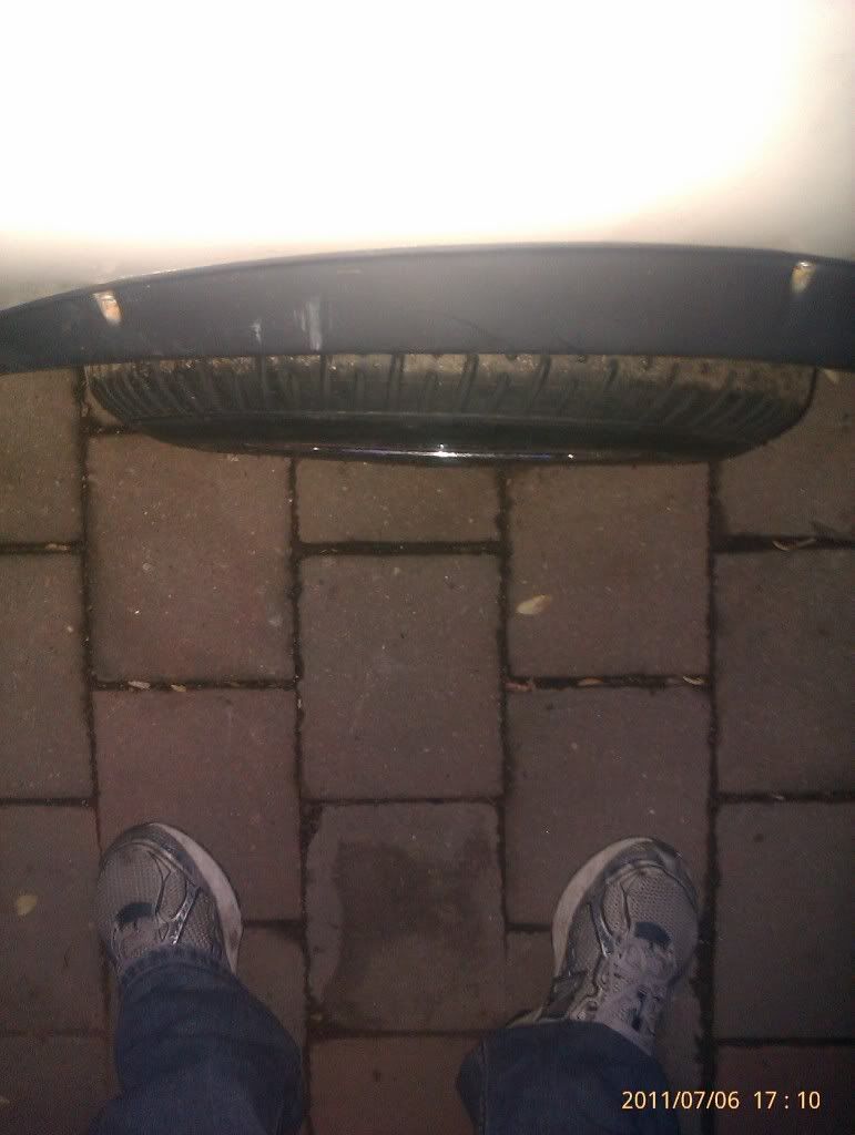

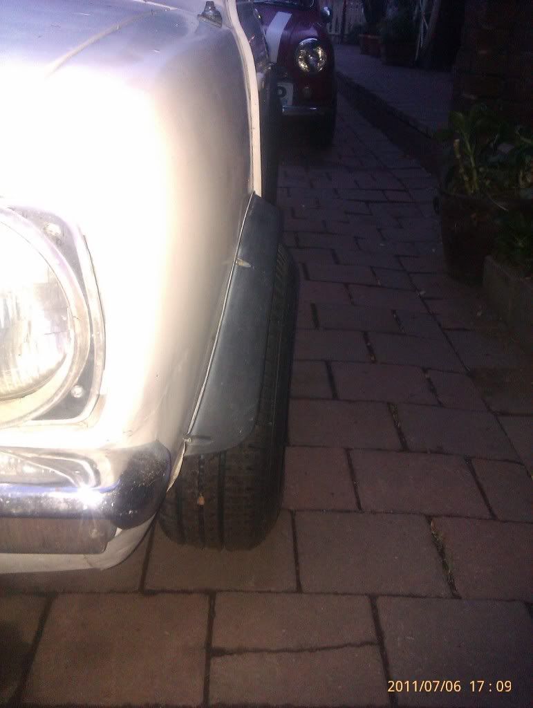

I purchased some 6x10 ultralights from UK from minisport from memory for my GT.
They arrived and I bolted them on. I had the horrible black plastic innocent flairs. They stuck out bad. So I had to go and buy some really wide flairs "group 2 race" from mini sport.
I couldn't turn the wheels, they hit the guards at the front so I attacked it with a hammer and dolly (would have been easier to cut it) and made the front of the arch bigger.
Here is a pic with the innocent type flairs, so you know what I mean.
