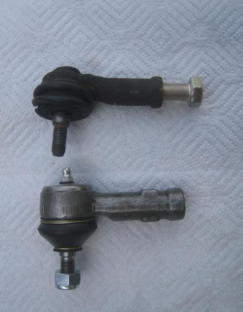

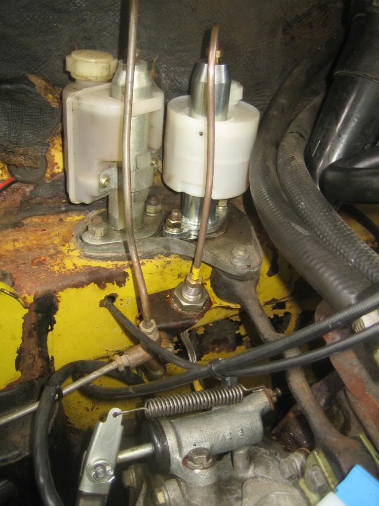

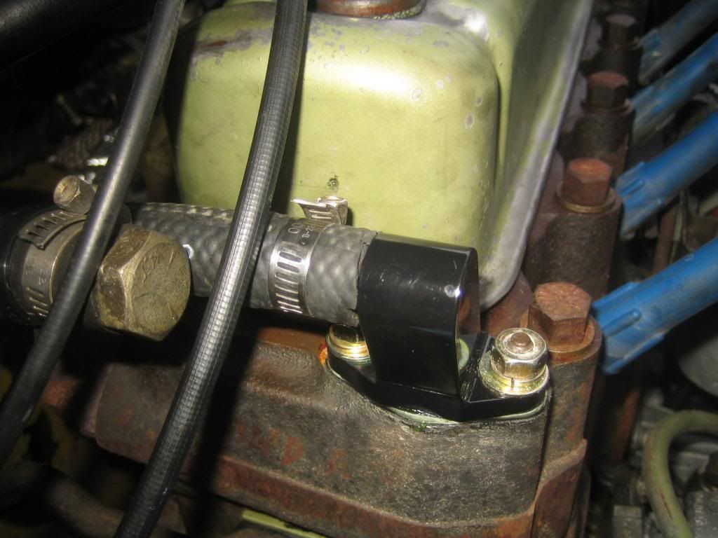

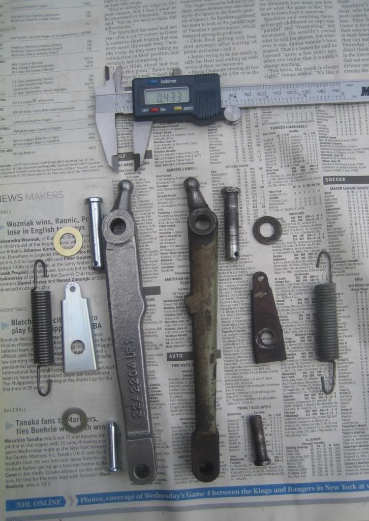

Preparation for ROO included rebuilt suspension with new springs, new knuckles, new Hi-Los at rear, new studs & S drums (& hub repacks), new adjustable lower arms, new wiggly pins, tie-rods & bushings at front, new steering track rod ends, new heater take-off, new clutch master, pipe & lever/pins etc.
Interesting...when the Koni Sport dampers came off one was at maximum stiffness the other at just one turn???? Both reset at 1 1/2 turns from soft to stiff. Seems good at that.
Not enough time to complete the 1293 & tranny rebuild with pot joints, so the trusty 1098 will have to do some climbing to get across our mountains to the flat bit east of the Rocky Mountains.

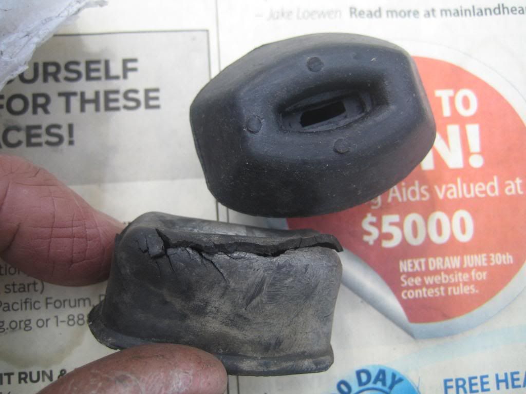

Got started Friday a.m. and quickly appreciated that we were heavy - truck scales at Hunter Creek said 1,040 kgs/2,288 lbs. (reading may have been high but still heavy). Adjusted rear height but still issues at left rear. Will pull trumpet this a.m. and see if new knuckle has broken...or just crap rubber doughnuts from Asia.
