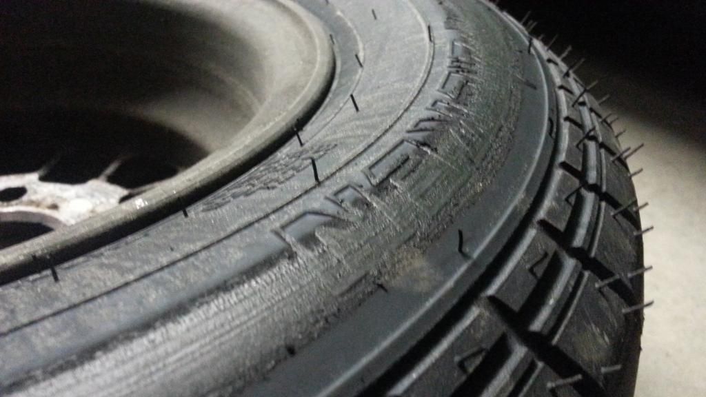

So I got some new Falkens (165/70R10) the other day... to replace some old bridgestone tyres (also 165/70s) on my contessa's
The Falkens are obviously wider then the bridgestones were, as they are rubbing on the rear shocks and trailing arms...
Bob Jane didn't even bothrting telling me about the problem, I just happened to notice when i was looking at the exhaust tonight...
I've attach some pictures showing the issue... will i need to get some space drums?
Are the spaced drums just a straight swap with the existing ones? or will i also need new wheel studs.... and are the studs hard to swap???
Thanks!

Will these tires still be safe to use?.. with the damage to the side walls?
1975 Hairy Lime/White Clubby
PostPosted: Thu Jul 03, 2014 9:40 am
To me the damage loks very minor, the raised lettering hasn't even been worn away, but thats just me and it may be the way it comes across in the image.
To be certain, just drop by the tyre place and have them inspect the damage. They will give the go or no go on the tyre.
