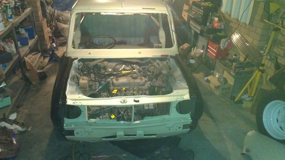

Hi guys and girls I'm looking at removing my two front guards on my 1977 Ls mini is there a site or instructions on how to do this at all? I have pretty much got the car striped
This is my mini

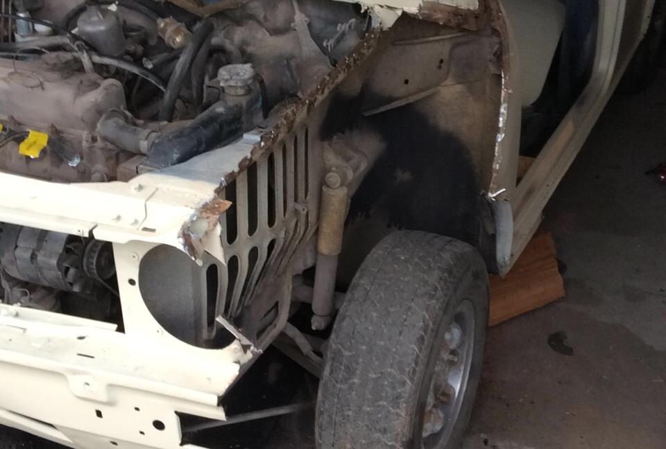

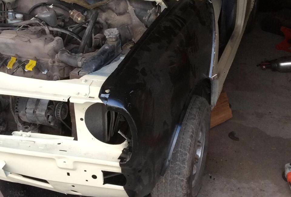

Photo links updated by moderator
 Post subject: Re: Removing panels
PostPosted: Sun Jun 15, 2014 10:53 pm
Its off! Looks good.
I've used spot weld drill bits, and while they're not bad, they don't always get all the weld area, so leave a little hanging. You also tend to go through to the next panel a little too easily, but they're great in places where you can't get a grinder.
