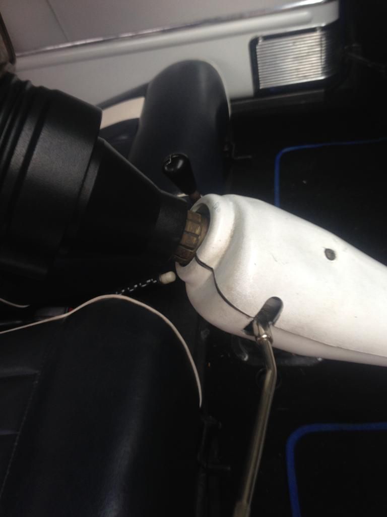

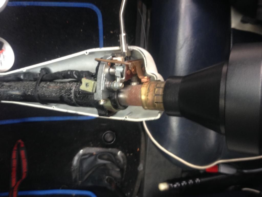

Ok I finally got around to taking some pics...

So I've pulled the steering column apart and yes need new bushes. But worked out the aftermarket sterring boss is what's causing my issue. It's 95m in lengh and 60mm from the spline. So gonna replace the bushes and try find a much smaller universal boss.

That it exactly what mine looked like before i redid the bushes. Different aftermarket boss though. I also got a repro shroud because mine was broken both top and bottom. The fit is terrible, but race car so meh.

The Horn Contact needs to be a bit further up to contact on the flat part of the brass slip ring. And make sure you get the Splines alignment correct with regards the self cancelling pin for the indicators. Make sure you do it with the wheels pointing dead forward.
