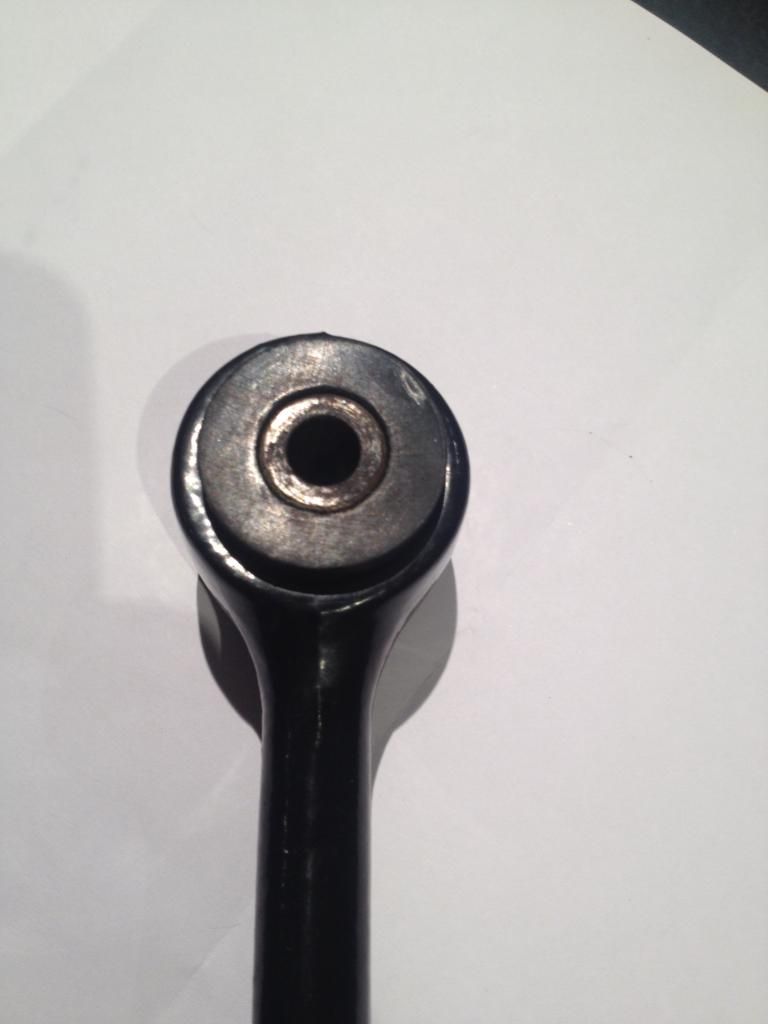

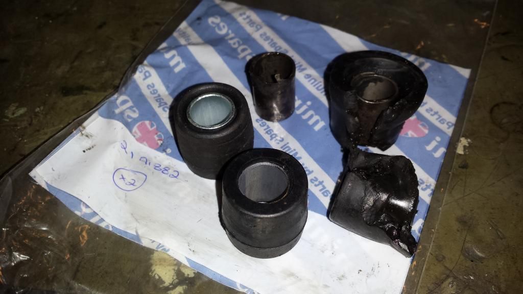

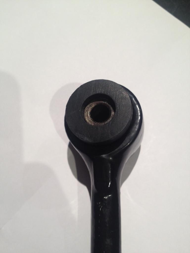

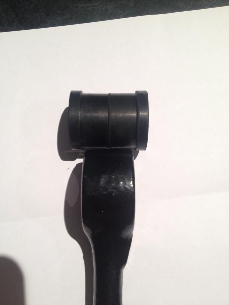

These modern rubbers while better than urethane bushes, are still not the best.
These are the 21A1882 lower arm bushes, and are about 5 years old. There are new versions of the same bushes on the left for comparison.
