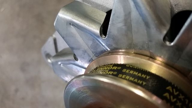

Hi y'all.
So I have kind of an update for you all. I took my alternator off and took some snaps for your opinions.
I also made a discovery this evening - The car ran fantastic, then it got a little bit later so I switched the lights on - then it started squealing! Turned the lights off, and it stopped. Does anyone know why this may be? I have H4 Halogens with relays. I should also note that the alternator felt quite hot once the lights were on

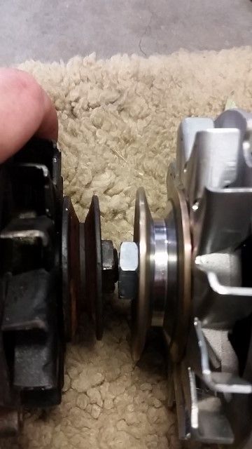

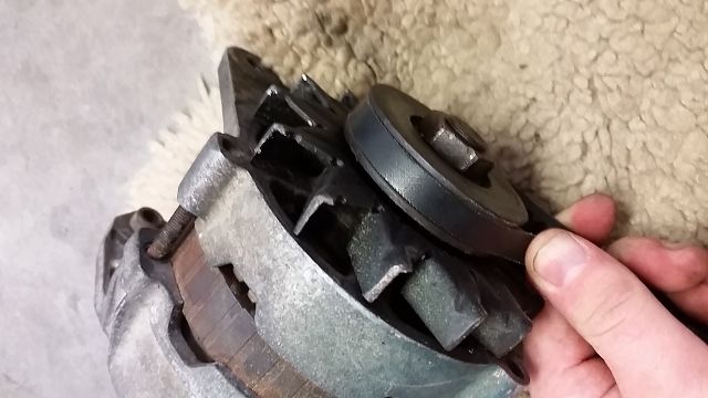

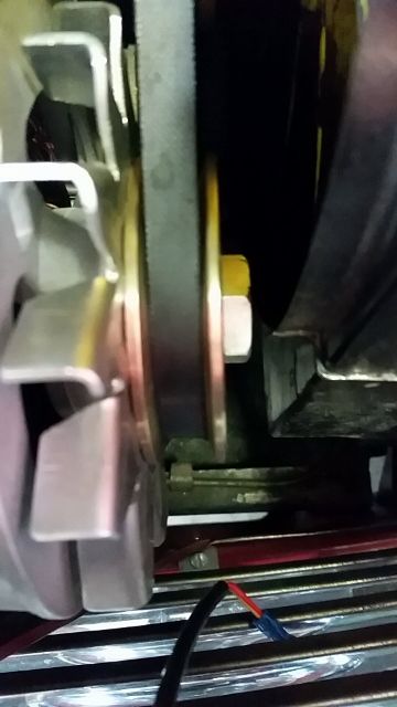

I had a closer look at the pulleys and took some comparative photos, the pulley V is very similar in total width at the top of the V. But as you can see in the photos the angle of the V is very different and you can see how far the belt sits in the V compared to the Lucas 15 AC next to it.
Alternator whilst on the car
side by side comparison (lucas on the left, 70 amp on the right)
how far the belt sits in on the lucas
How far the belt sits in on the 70 amp

Wherever you bought it, that looks like it was for a truck with a B section belt.
Wrong pulley!!
PostPosted: Sun Jul 27, 2014 9:04 pm
You have the wrong pulley. The one you have is for a much wider belt.
The V belt grips on the sides of the pulley and is not supposed to touch the bottom of the pulley.
