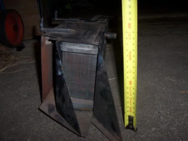

I have an engine bay mounted heater I'm trying to fit to my Morris 850 but it doesn't seem to fit, dose anyone have a picture of one fitted in a mini :?:
The only markings mine has is "PAT PENDING 2.3711/62" it just seems to large/long to fit :? .

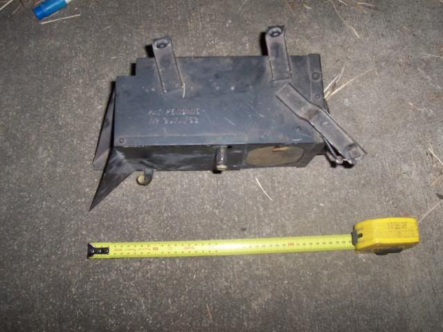

Hey Mick it is not that type, it dose not have a fan just a rectangular box with a matrix in it.

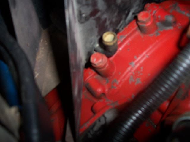

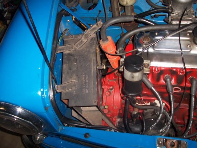

Got some photos, that one looks right.
Mine currently hits on the bonnet stay and the clutch cover. Hopefully it's just a matter of wiggling it in to fit.
PostPosted: Sun Jul 27, 2014 8:05 pm
I had to bend the bonnet stay to fit. And mine is a Matic with this heater fitted stock.
Early heaters had 3 bolts, later ones had 2 at top and a Moke style bonnet V rubber at bottom that sat over a wide |_| bolt.
None of these heaters had a fan so they did FA heating when stopped in traffic.
I put a 3" Attwood bilge blower in the ducting of mine, noisy but it works.
http://www.biasboating.com.au/High_Capa ... p/4646.htm
I cut the 2 legs off it.
