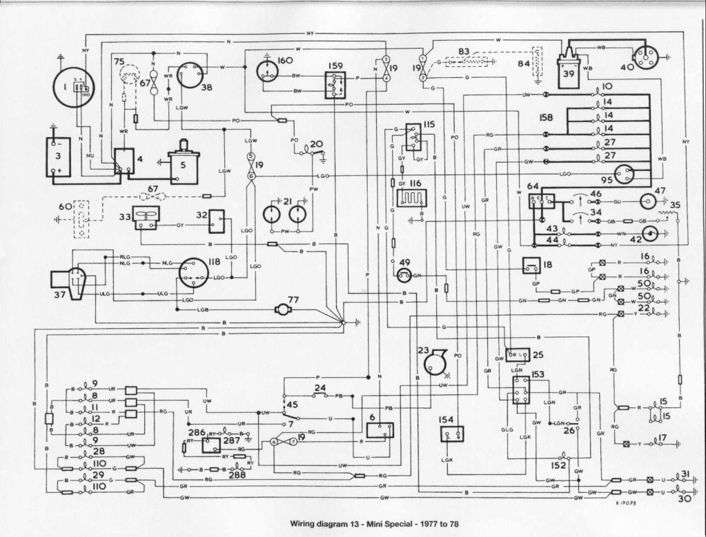

My car (1977 NZ roundie 1000) came in several boxes of bits from last owner. Wiring loom was mostly complete but a few bits missing or damaged here and there. I'm trying to piece together and trouble-shoot the indicators and hazards, and only have this diagram:
http://www.minimania.com/images/wiring/ ... ring12.pdf
It lists hazard flasher in the components but I'm damned if I can find it on the diagram....anyone got a more complete diagram or was this missing in the original manual? The loom does have two flashers (one two wire, one three), and a hazard switch, but I was wanting to see the termination points of the wires and their colours to properly trace it all. Cheers

I'm not sure if this will help! It shows the hazard flasher unit.
