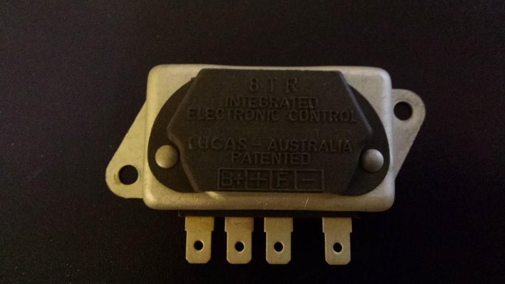

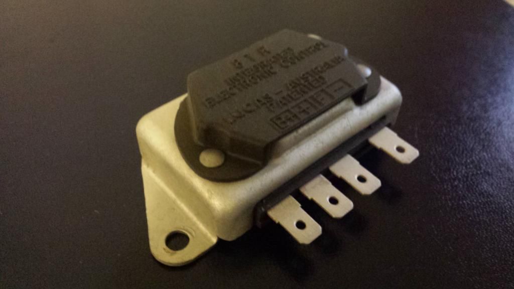

I pulled up at a likely looking garage sale on my way to Tumut today. The guy had some old bits of cars, so I thought their may be a mini bit too.
There wasn't anything special to be honest, apart from what looks like a brand new 8TR regulator which anyone who owns a post 69 to 71 Mini will know as the external regulator for the early alternators. Usually blown and diabolical to find as well. This one came in a little Lucas Box which fell to bits. It does have screw marks though... Works fine too.
Its nice to find rare early mini, Cooper S and GT stuff, but every now and then a little gem like this is good to find as well.

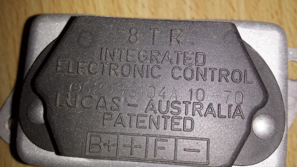

Mick - does it have a part number (8 digits) and date embossed on it?
PostPosted: Sun Aug 31, 2014 10:06 pm
It does.
062938104A 10 70

Mick wrote:
It does.
062938104A 10 70
That's the correct one for BMC cars according to the Lucas Australia catalogue. There's other models of 8TR that aren't appropriate.
By the way, that first character of the part number is not a zero but some sort of trade or other mark, like a Mercedes three-star mark.
