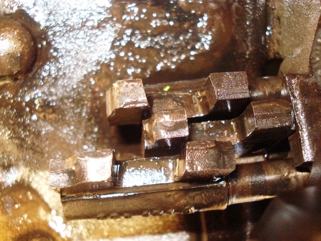

Below is the position of the selector rod ends when the gears are locked (the bottom one shows first gear engaged when it is fully to the left and the middle one shows fourth gear engaged when it is fully to the right-the upper one is the reverse selector rod);

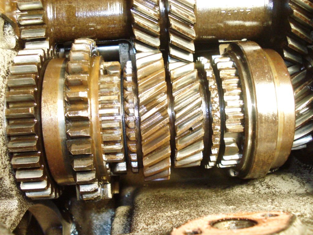

Here's a pic of the gears when first and fourth are engaged (first is engaged on the left and fourth is engaged on the right);

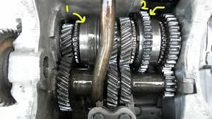

And here's a pic of the gears just before you engage them from someone else I found on the web (you need to move (1) to the left and (2) to the right to lock up fourth (1) and first (2).
Pretty sure I've got the gear positions correct but hopefully others will let us know if it isn't (it worked for me).
