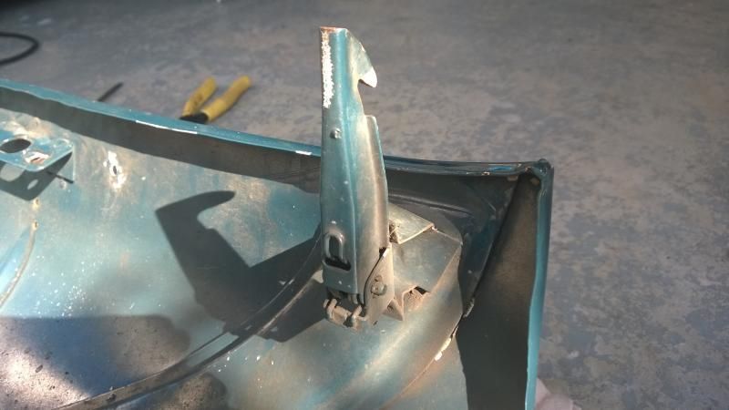

Also on this subject, should I remove the bonnet catch entirely or is it best to leave the spring alone?

The hook can come apart, its easy to assemble. There will already be a large pile of small and seperate items to be painted in any case.

Hmmm, food for thought. Mick, just realised how easy the bonnet catch comes off, I thought the spring was going to go everywhere but it doesn't, cheers.
