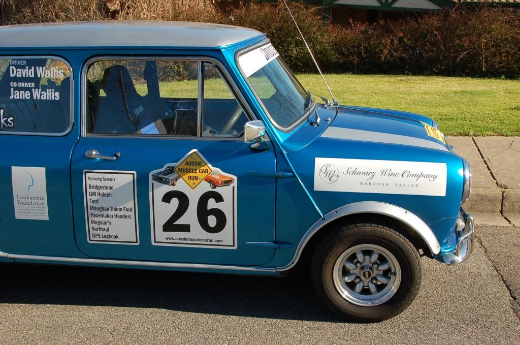

Hi All,
We will be doing the Bathurst SuperSprint in early November. Part of the Aussie Muscle Car Run to raise cash for Leukaemia.
The Sup Regs call for a radiator catch can and towing hooks or similar device for front & rear.
What do people use for radiator catch cans and rear two hooks?
Any photos much appreciated.
It is in a Mini K as per the photos.
Standard rubber subframe at rear.
