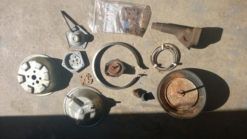

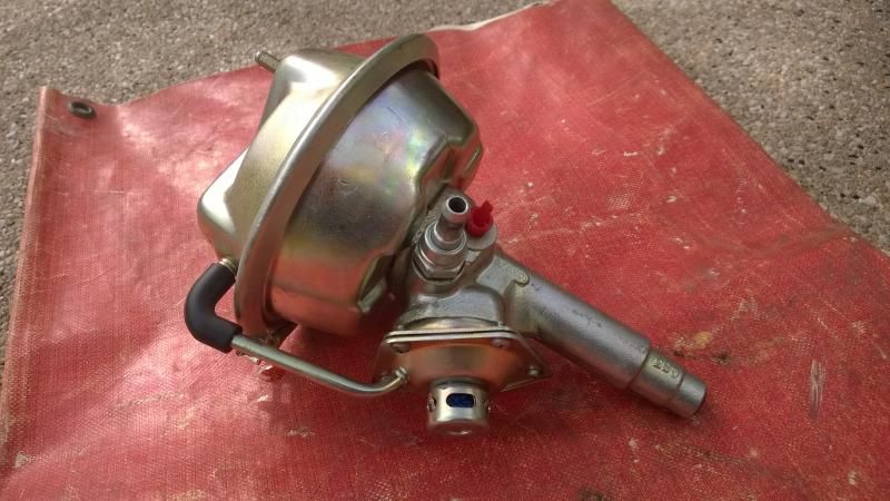

Not sure which state you are in but you could post I guess. I just got mine done at vacair. Cost about $300- I think. I called hydroboost but he wasn't interested and told me to try vacair.
Vac Air Services Pty Ltd
Brake & Clutch Services - Thomastown, VIC
Clutch & Brake Reconditioning, Repair, Resleeving, Booster Services
38 Commercial Drv, Thomastown VIC 3074
(03) 9464 2122
Oh, and don't take a booster in that has already been disassembled, they were not at all happy! (even though I bought it that way) and didn't want to touch it.
Before
After
