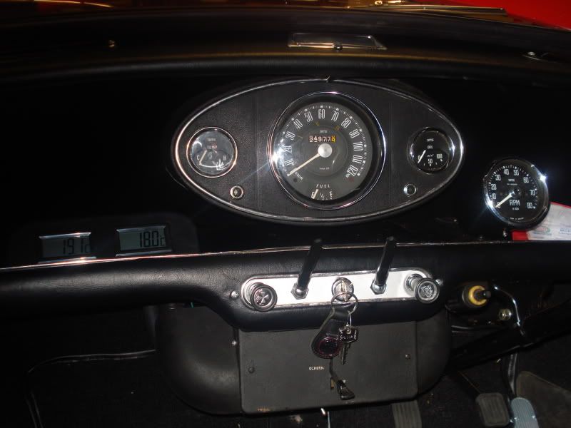

I've been running a pair in my car for about 5 years straight, and I used to have one in the previous car as well.

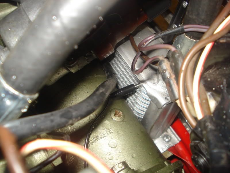

It sneaks under the thermostat top hose and tells me the outlet temperature to a degree.
You need to get a small piece of rubber and cut a groove along its width. Lay the wire through this groove. The hose will never conform to make a perfect seal if you don't. I also needed to put a piece of heatshrink over the temp sense end with epoxy inside which cured after the heatshrink shrunk to keep it watertight.
The oil temp goes into the back of the oil cooler, next to the inlet with the front fins closed to keep the temp a bit more stable. Its not super-dooper precise for the oil temp from the pump as wind cools the fins a little as you drive, but its only a few degrees off and beats piercing the oil line or sump integrity for my use.
Runs on a 3 dollar battery that lasts about 10 months if I don't remember to turn it off.

Mick wrote:
Something you find harder and harder to see "these days"..
MADE IN AUSTRALIA :cry:
