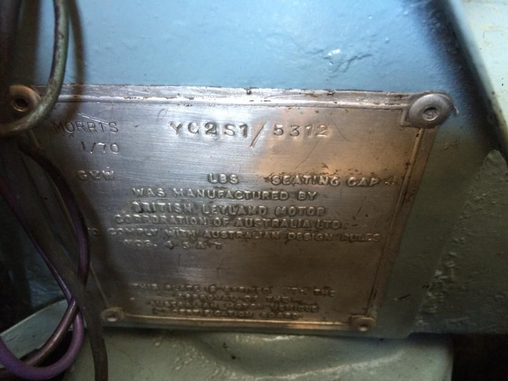

Recently bought a 1970 Morris mini K.
Trying to see how original the car is, the car is dated on the plate as being produced 1/70 and most of the components are stamped 12/69 which would seem to make sense...
The engine numbers ending digits look to have been ground and re stamped at some point...
Attached are a few pics of the plates etc, Does everything look ok and as it's meant to for this car or are there some discrepancies with regards to some things?
I can't find any stamping on the firewall but I'm not sure exactly it's meant to be located.
Any input greatly appreciated.
plate located on the drivers side bulkhead near the subframe

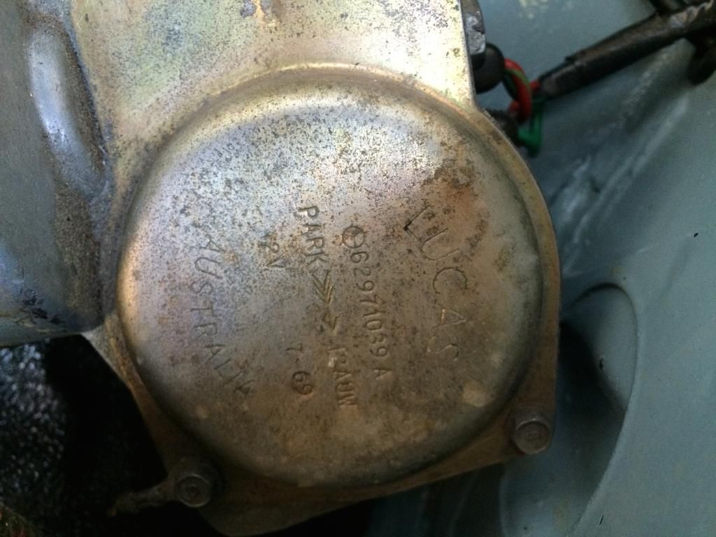

Wiper motor...

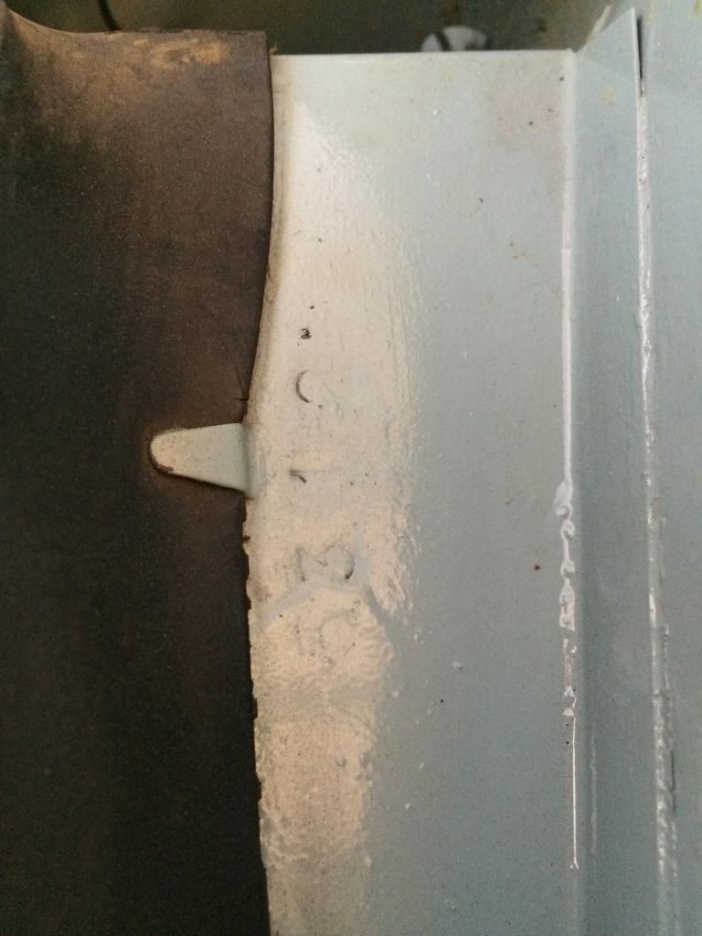

this is on the firewall...

looks lovely and original to me :)
my K was originally cadet blue and had horrid dark green house paint over it. I loved the cadet blue that was in the boot though...
some will tell you the ID plate should be stamped from the back, but I've seen a lot of cars with it stamped from the front like that. I reckon the rear stamping was done by a machine, and the front stampings done by hand when the machine was broken. Those ID plates were introduced in January '70, and your car being that month (cool!) it may be one of the first that got the ID plate put on it.
The number on the radiator shroud should match the ID plate, and should have the prefixed YG2S1, yours might not have been stamped, or may be covered up. If you can get your finger under the shroud, or use a mirror, you might find it.
The number on the firewall should be behind the clutch master cylinder, just below the paint code sticker. It may have been missed, or may be covered up.
Also have a look in the passenger side of the channel at the back of the engine bay (where the rear lip of the bonnet goes when you shut it), the car number might be stamped in there. I've only ever seen a couple of cars that had it stamped there, and none of mine have had it.
45 years ago when these cars were sausages being pumped out of a factory, not all of the employees were "fully engaged" in what they were doing - some cars have the wrong numbers, some numbers upside down, some stamped from one side of the car and others from the other side of the car, and all sorts of weirdness. Don't get too hung up on it...

Don't think the firewall should be stamped. Looks very original. Date codes could be anywhere from 6 months prior to the build date as some components were UK built or stored on the shelf.
More pics please. :D

Yea im not sure about the number stamped into the Scuttle...feels like there might be something there but the paint is covering it. pretty confident that the prexifed YG2S1 ain't stamped on the rad cowell.
