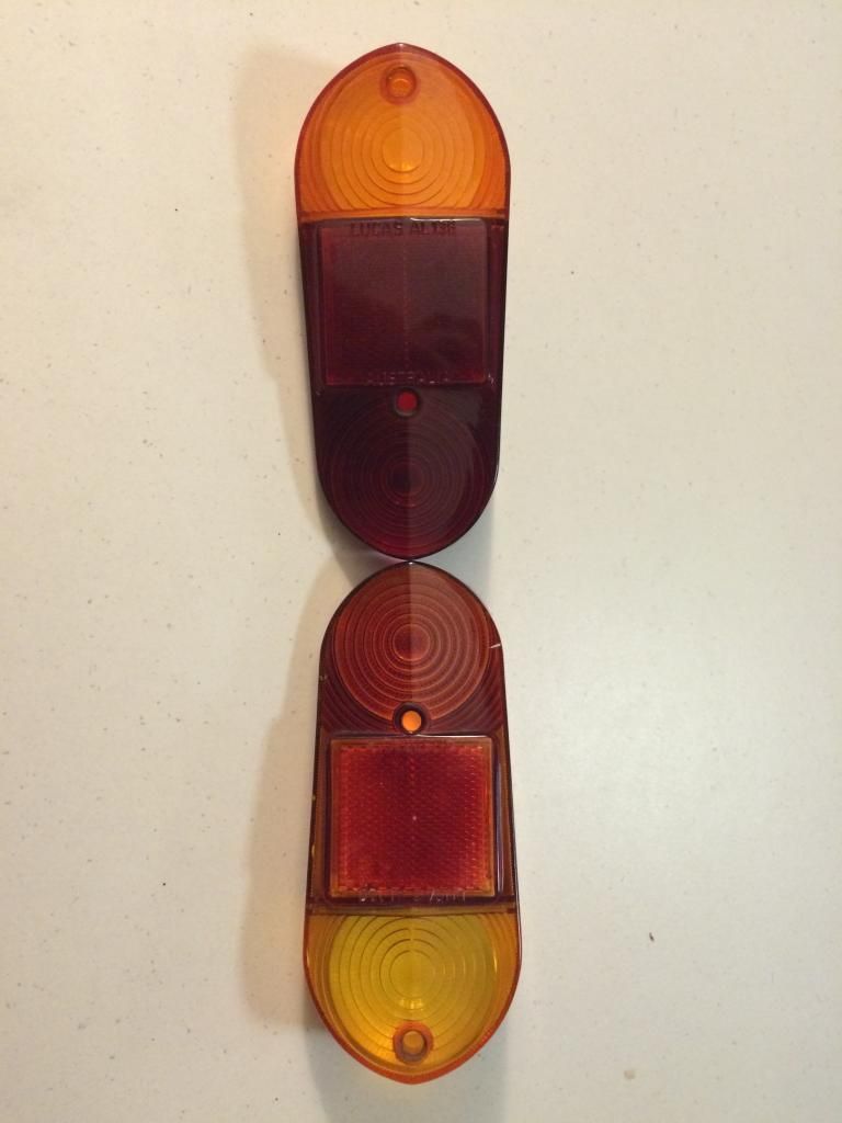

Hey, is there any way of restoring rear lenses?
They are form a 1970 Mini K.
I've looked for replacements but I'm struggling to find any genuine ones, "LUCAS AL 136 AUSTRALIA"
wouldn't be so bad if they were both the same amount of faded but ones worse than the other so it looks a tad shoddy.. also...I would need some gaskets for in-between the lenses and the actual light, these only seem to be sold with a whole light unit.
Any Ideas?

Can you just swap sides so the fading on the other catches up? Ha ha....

Could try this
http://www.vhtpaint.com/products/niteshadesred
Never used it but have used a similar brush on type to turn a clear marker light into a tailight for a motorbike with good results

There is a paint you can buy from car parts shops
I brought some about 20 years ago for a uc torana front blinker lenses
You paint it with a brush on the inside of lense
the bottle was like a nail polish bottle that girls paint there nails with from memory

cool, might look into getting some of that. its the orange too! hmmmm

You can buy clear orange and clear red paints from hobby shops. Tamiya make some, there maybe other brands as well.

Dont know if its the same stuff i got same sort of bottle but
http://turinimports.com.au//index.php?m ... ucts_id=71
http://turinimports.com.au//index.php?m ... ucts_id=72

I bought some orange tint years ago from AutoBarn and redid my Lucas ones. They still look OK...
You can buy new 2 hole lenses from Karcraft and elsewhere, but I found they faded bad within 12 months when parked outside.

This looks like it may revive them
http://www.ebay.com.au/itm/Tail-Light-L ... 27ccecd43c
