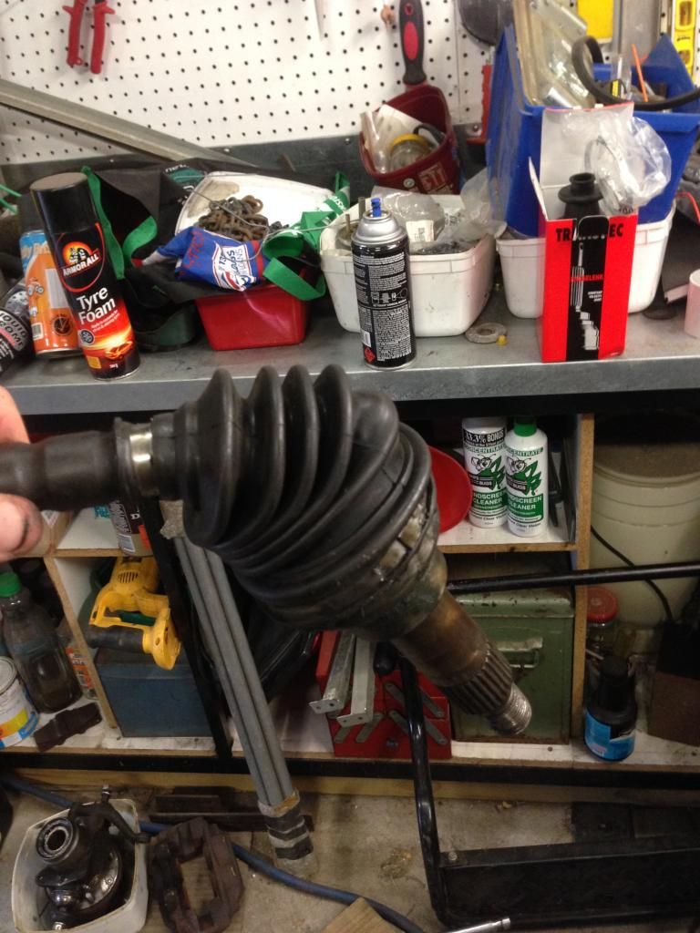

So I wonder why the CVs been quite noisey..... I think I may have found it....
Thanks for the advice and heads up on the how to thread was a great help just to refer back to make sure I was doing to right.
