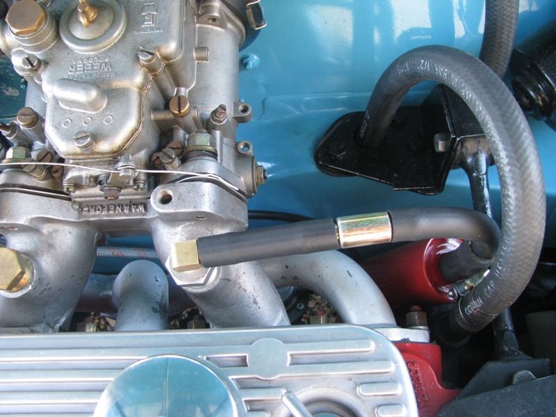

You need a PCV valve into the manifold, 1 side will do.
Run that from a Cooper S side cover breather.
Block the breather hole in the alloy cover with a plug.
You can use either a plain plastic oil filler cap or the Cooper S one with a little breather in it, either will work. (I run plain type on my 1412 and an S one on the 1360).
BTW it doesn't need to be a Cooper S PCV valve, an inline Toyota one works fine.
Like this one I got from Repco-

Took all the good advice and purchased a PCV (from AutoOne Goulburn thanks Morris1100). Gave it another good run up to Mini King Today not a drip of oil anywhere. All was good. Used a cooper side plate and blocked the hole in the filler cap.
Thanks again.
Dalmeny

I'm glad you had great success with the pcv-013.
PostPosted: Sat Jul 21, 2012 6:37 pm
Posts: 39762
Looks good, glad it works just like mine.
I'd put a decent size black cable tie round each of those hose connections and cinch them tight. Looks neater than hose clamps and works just as well. :wink:
