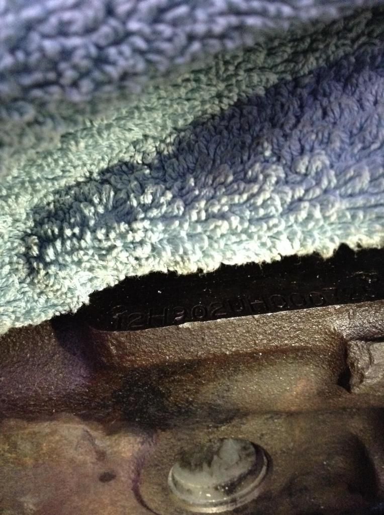

I just went and pulled the cover up on my original 1275LS engine and the dipstick tube was sitting next to it. But it's a metal one.
Also here's the engine number.
It's the same as yours.
So I'm guessing your should probably have a metal tube aswell??
Cheers, Rhys.

Hi Rhys,
Thanks for the photos.
It seems that someone has removed the steel tube from mine
and that's why the stick is loose.Also that means that there is not enough oil in the engine due tube missing.
