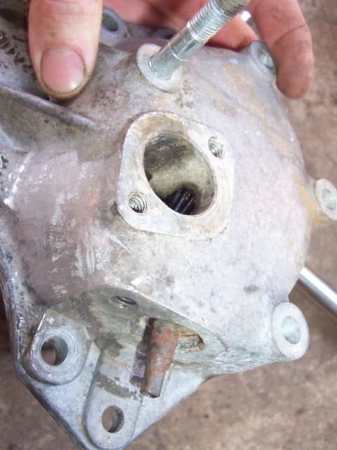

I plan to fully rebuild a 4 sycro remote box. This box is for my 1360 BMW twincam build, it'll have a Quafie ATB diff with a 3.1 FD and the engine will be tuned for torque. So with all that in mind.
I'll have a heap of questions but for now I'll only ask five. Currently I have striped as much out as I can and I need some guidance with a few things.

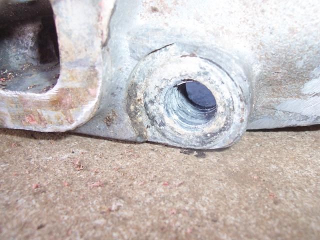

(1) The drain has striped out so what are my options :?:
(2) How do I and is it nessary to remove the speedo drive :?:

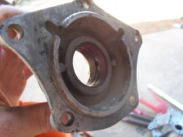

(3) Should I replace the driveshaft output bushes (the bearing thingy) :?:

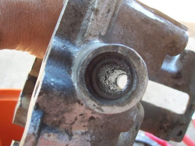

(4) The top and bottom bushes in the diff housing for the gear selector shaft, the shaft seems to move around a bit in them. How tight/loose is the shaft meant to be, should I replace these :?:
(5) cleaning up the threads on everything, what taps and dies do I need :?: And I'm assuming I leave all the studs in where they are correct?
You can get plugs for stripped drain threads here, but you will probably be better off with a helicoil. I have never used a helicoil, but i have one on my gearbox in the same place, and it works well.
Only if they're worn, I'd say. I've never seen them wear down before, but they may well do.
They shouldn't be tight, but they should move freely with little sideways movement. I'm not sure what you would do to fix that.

For the drain plug I helicoiled it - have some left over if you need it.

The 2 side cover bushes are usually worn- press new ones in then get them set up true in a lathe and machined to size for ~.001" clearance on your drive flanges or pot joints. If you leave them worn the seals won't last long before leaking.
These bushes are about .007" undersize when bought.
The 2 shift shaft bushes in the diff cover wear bad and should be replaced. I screw a 9/16" UNF tap in, then use a hammer and a bit of 3/8 rod to drive them out. You could also use a 14mm tap.
 Post subject: Re: Gearbox rebuild
PostPosted: Sun Oct 12, 2014 7:29 pm
4/ you can just catch the side of them with a long drift, or use a slide bearing puller. Easy job
