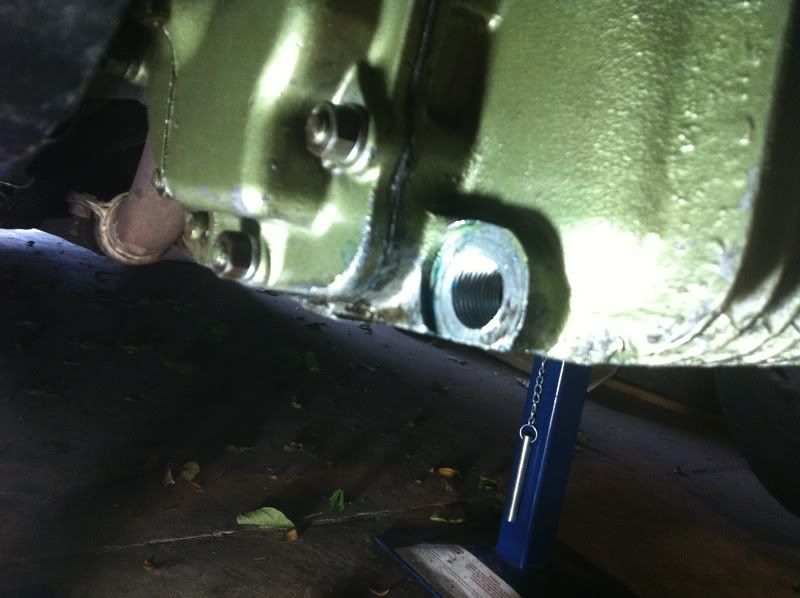

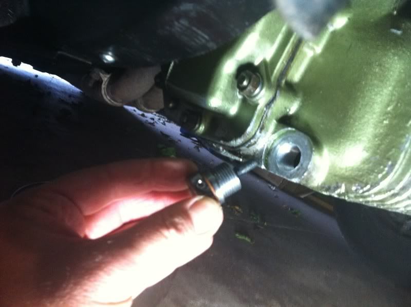

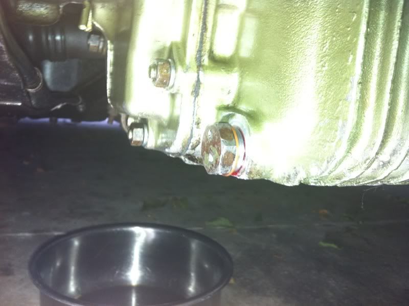

Today I was able to tap my sump out to 3/4 in UNF (as above) and install the steel adapter made by Dr Mini from a design by 4myego.
Very happy with the result.
Big thankyou to 4myego for the original design and to Dr Mini for making up the adapter for me.
Pics.... sorry about the quality.
^^Sump drain drilled out to 17.5mm and tapped to 3/4 UNF ready to receive the steel adapter.^^
^^Original sump plug used to screw in adapter, Thread locker was applied to the thread before installing.^^
^^Adapter installed.^^ :D
