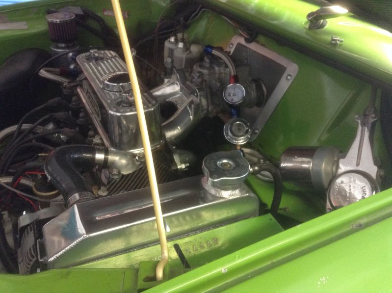

As part of the restoration of my MK II Cooper S I want to use original Cooper S pressed metal extractors. The main reason for doing this is so as I can maintain originality by keeping the one-piece heat shield (ex Midget/Sprite) that came with the Police specification motor. After-market extractors have a wider curve on the centre pipe as it exits the exhaust port so they hit the heat shield. Factory S extractors have a flatter curve but the metal is quite thin so they burn or rust through quicker than steel pipe extractors.
If I get the S pressed metal extractors ceramic coated will it extend their life? Has anyone had this done on S extractors? Are there better alternatives?

Hi Ron,
Thanks for the info, but you are describing a different set-up to mine. The MK II Cooper S Police Specification (SPO41) includes a one-piece heat shield derived from the Sprite/Midget range. It was modified by trimming metal from the bottom and sides, opening up the 1 1/4" ports to 1 1/2" and re-drilling the carby mounting stud holes and return spring holes (see picture below). The other picture is of my engine as it is now with after-market extractors and the one-piece heat shield, which is no longer flat but bent in a few places so as to clear the extractors. The original S extractors will enable me to get the heat shield flat again as per the original design.
