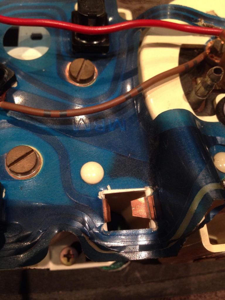

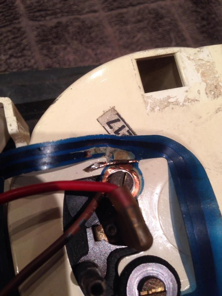

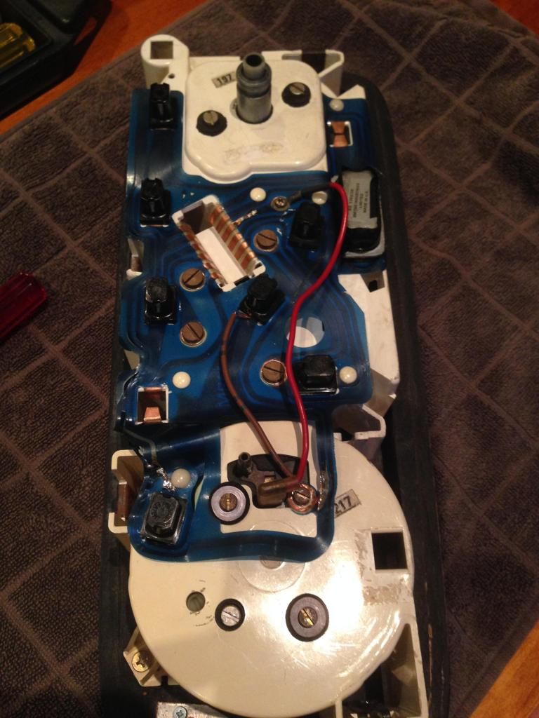

I have pulled out the cluster and as you can see from the pics it has a few band aids the problem seems to be that the copper contact for the globe has worn through / split. Tested access the gap with a multi meter and voltage is all good it just isn't getting to the globe. What do you think repair or replace ?
1972 Leyland Mini Clubman
2000 Honda CBR929RR
PostPosted: Tue Jan 27, 2015 8:14 pm
I'd get some copper shim and `carefully' solder it onto the track, then bend it slightly into the hole, to match the good one. Once happy, put some super strength araldite epoxy over the repair area to reinforce it.
PostPosted: Tue Jan 27, 2015 8:26 pm
Posts: 3022
Location: JIMBOOMBA QLD.
Then do it again in a few weeks. You can not solder successfully on these type old Flex PCs. It is not worth the trouble repairing these when you can get new ones that are made from more modern materials. Up to the owner after all.

I agree with convertible mini, I tryed to resolder some broken tracks, but its impossible to do it without burning the rest of the board, then reassembling I managed to make a few more cracks on some tracks. The old board was just too brittle!
A new board works so much better, a few plastic rivets and a couple of screws and its done, no faffing about with the soldering iron!

New flexible circuit board arrived, really easy job to replace and works a treat. Much easier to replace than stuffing about trying to solder or bridge contacts with additional wires which was how it had been done before. Looks nice too not that I can see it now its in the car !!!!
Thanks to Tony aka Convertible mini for supplying quickly.
