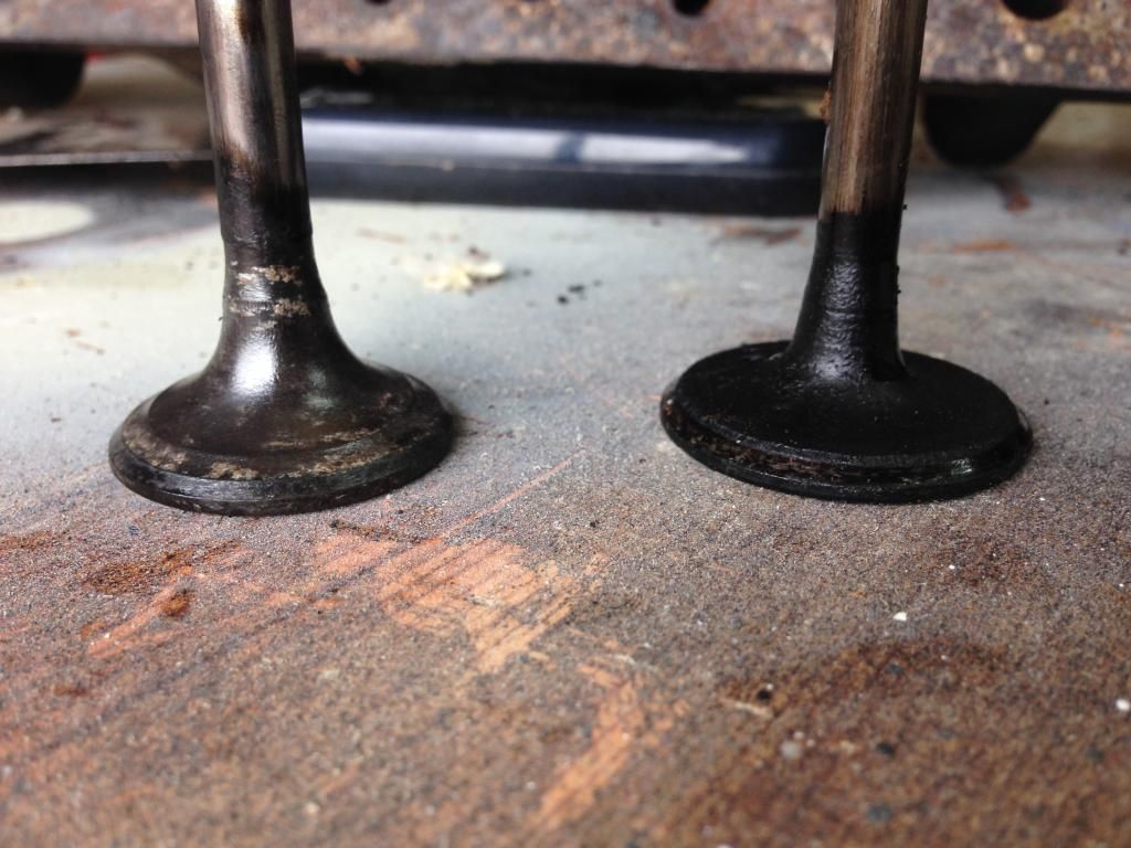

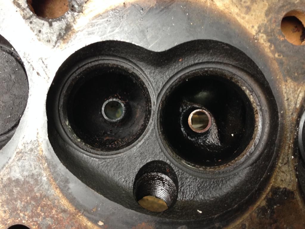

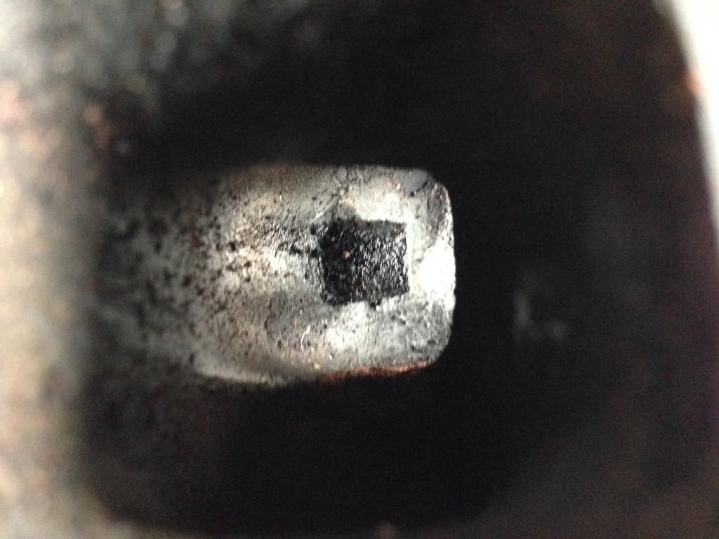

I took some photos (not as well as Jacobs though).
I think my 940 has "open" exhaust port.
Looking in the exhaust manifold port
The current valves

Oh dear, worry, worry...
Posts: 692
Location: North Rocks
Hi phill 850
Don't be worried about the boss in the exhaust port a std one of those heads (12g1316) will flow 92 cfm @.300" lift and 98 cfm @ .400" lift and that is corrected figures at 25ins on the end exhaust port, which is enough to make a lot of HP.
BMC right through the ages on all there motors be it A/B/C series there exhaust flow on nearly all there heads will out flow the inlets and the did this to achieve good fuel economy, a good example of this is with the MGB they flow a massive amount of air in come parison to the inlet, with the small bores they all run a 1" ins exhaust valve which will out flow the inlets, wait till part 3 of the 68mm project comes out you will see the flow on the exhaust port you will find very interesting.
Graham Russell
