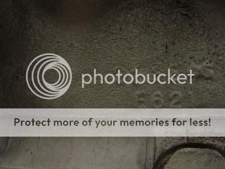

Any ideas what this Gear Box is from, casting number looks like 22G845, doesn't match any normal mini number
It's a 4 sync remote that I have been running on my mini for a couple of years , can't remember where I got it from.
PostPosted: Thu Feb 19, 2015 10:14 pm
Posts: 39756
That's a 22G846, as I mentioned above.
Functionally the same as a 22G1128 4 synchro remote box.
PostPosted: Thu Feb 19, 2015 10:18 pm
Joined: Sat Sep 13, 2008 12:37 pm
Posts: 193
sorry, how did I miss that, thanks doc
