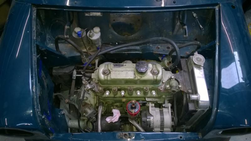

Stripping the car back to shell. (I will start a post on that soon) I assume I need to get the wiper assembly completely out. Do I need to undo the small nuts (as shown on picture 4) on the wheelbox assemblies to get them both out ie. remove the wheelbox to wheelbox outer cable from the assembly first and then they will drop down and out? It looks like it in the manual. I may have answered my own question but thought best to ask before breaking something or doing something unnecessarily. Cheers.

If you loosen the bolts they will spin on the shaft. That will make it abit easier.
But I am pretty sure if you hold your tongue the right way and bend those little tabs out of the way it is posible without loosening the nuts.

Its never very easy, and they will bind on the holes as it comes out.
There's a knack to it I am sure, but they don't just go in and out without a little bit of rough house being applied.

From memory, just loosen the nuts, but turn the black plastic spacer around 180 degrees on the shaft and give it all a bit of a jiggle.

Thanks again, got it out by turning the spacers around and pushing wiring loom metal lugs up and a bit of manoeuvring. Didn't have to undo any nuts to disassemble. Cheers.
