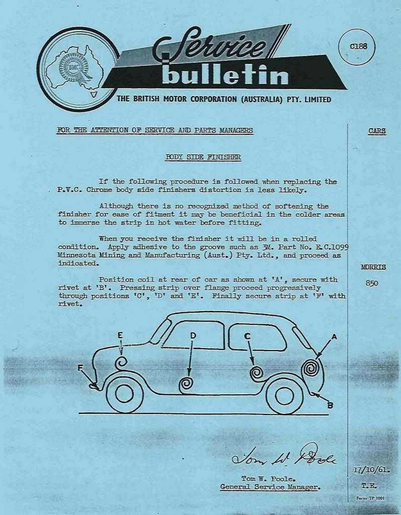

PostPosted: Wed Jan 29, 2014 9:20 am
Posts: 6750
This is what BMC advised:
PostPosted: Wed Jan 29, 2014 8:08 pm
Joined: Sun Sep 15, 2013 9:11 pm
Posts: 233
Location: Western Australia
Blimey! Talk about Ye Olde Instructions!

PostPosted: Wed Jan 29, 2014 8:16 pm
Posts: 2663
Location: Muswellbrook -- NSW
Thats excellent Doug , thanks .
It will be a job for me down the track somewhere as mine have started to shrink where they bend
round the flairs .
