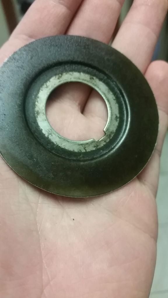

Hi everyone
Was cleaning around the timing gear to refit the gasket and cover when I accidentally knocked the round spacer that was siting on the pulley shaft.
It has like an indent on the inner ring, so does it sit so the indent is rad/pulley side or does it sit so the further out bit sits next to the block?
Seems like a stupid question but I have to get it right!
James
PostPosted: Sat Feb 21, 2015 1:24 pm
The convex face you can see above goes outwards.
Thanks doc - except that's the concave bit in the photo haha :D
PostPosted: Sat Feb 21, 2015 1:46 pm
yes the other way round :-)
should be an "F" on the convex side, means "Front"
Sorry yeah my bad, didn't have specs on. It is concave there, ain't it! :oops:
Duplex ones have F marked on em, I dunno about the deeper simplex ones like yours.
Cheers guys
Mine looks as though it has an L stamped into the convex side. (single chain)

It is called an oil slinger..

Just so you know, there are 2 types of slinger.
The one you have will only fit with a single row (simplex) chain.
There is also a flatter one that is made for a duplex chain, but will fit with either.
