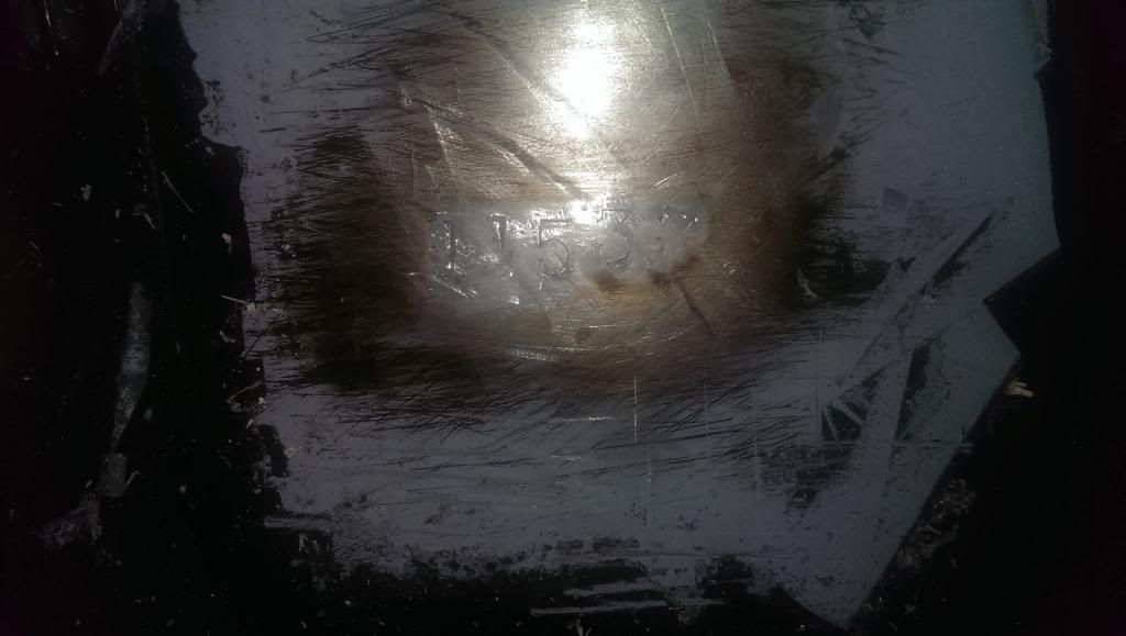

I could not find any number on the radiator shroud, found the one behind the brake/clutch masters though, which is " 11537 "
it has been primed then like body deadner/ruberised-paint painted in the engine bay so i had to scrape back the paint in all the possible locations.

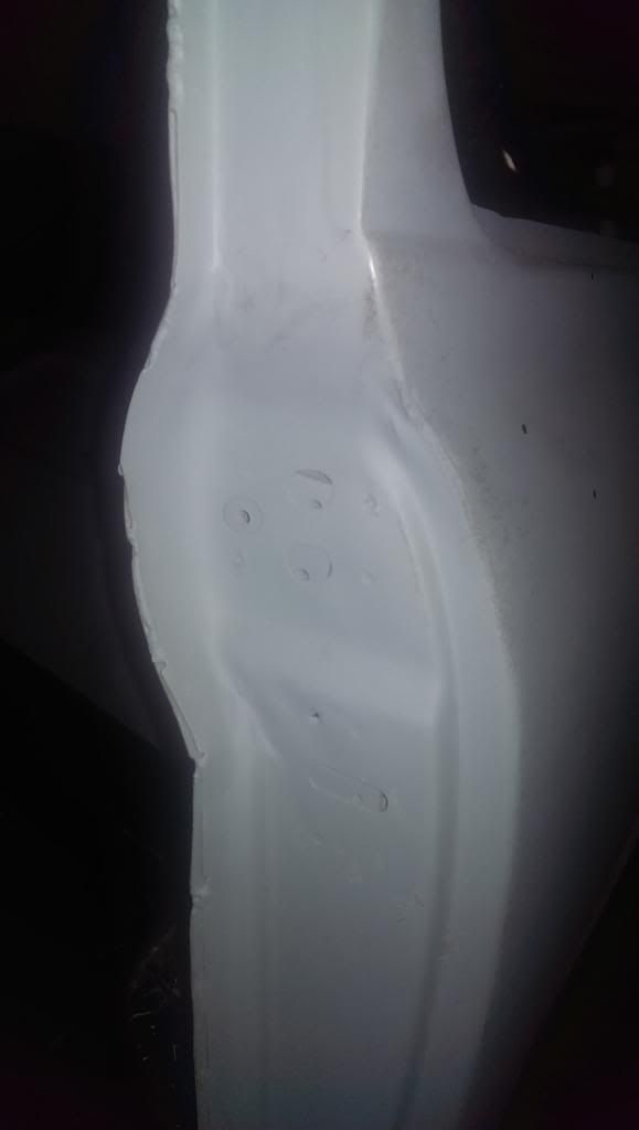

it has no doors, I know what clubman doors look like also btw, I have doors in the shed for it off my 63 mini.
the body takes external hinges, I have added a photo of where the door would close if this is what you meant?

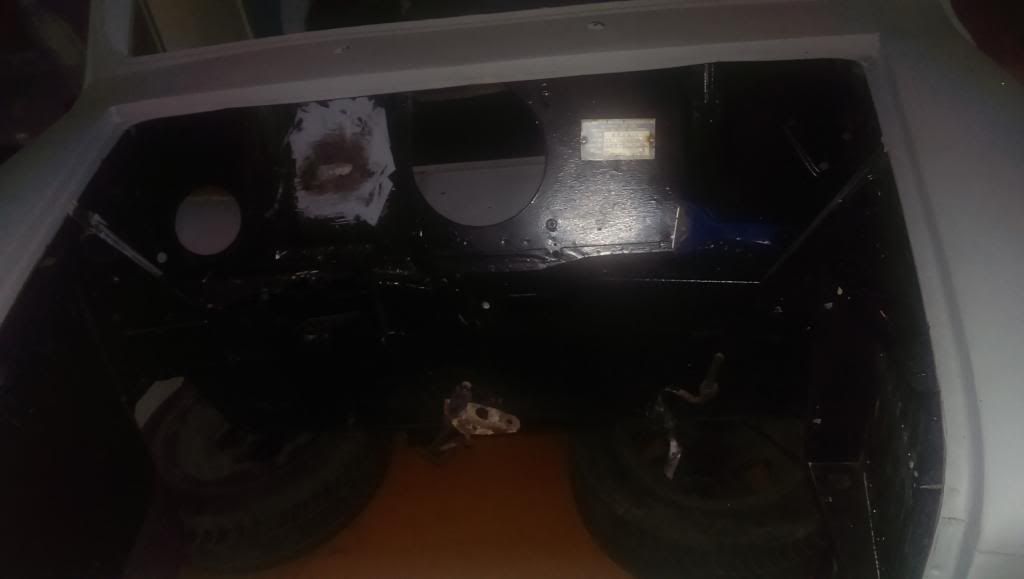

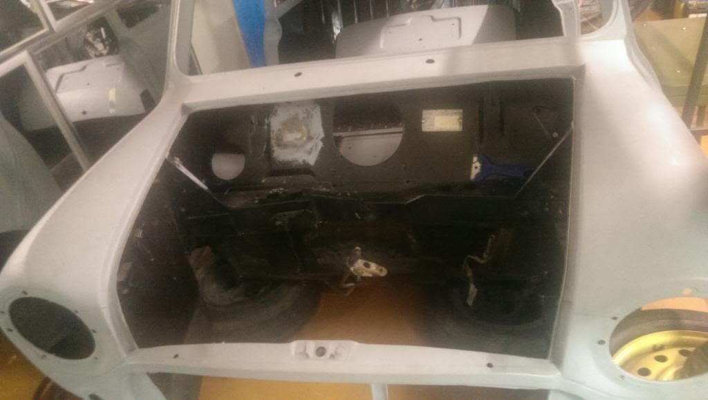

the ID plate you can see on the firewall is the wrong one I mentioned earlier btw, riveted in the wrong place by the previous owner and the numbers do not match.

PostPosted: Mon May 12, 2014 6:43 pm
The firewall looks like a Mini Deluxe, 1965 to 1969.
It is not an 850 or K firewall unless it has been modified.
If the number is right it would make it a Deluxe from 1966.

That body number looks like it has been welded, ground back and restamped.
Can you see the back side of the stamping from inside the car?
Edit, Did you take to it with a grinding disc?

It's body dead end on the back also. I'll scrape it back and take a look.
The photo looks bad but that's due to me scraping the paint layers back to find the number.
