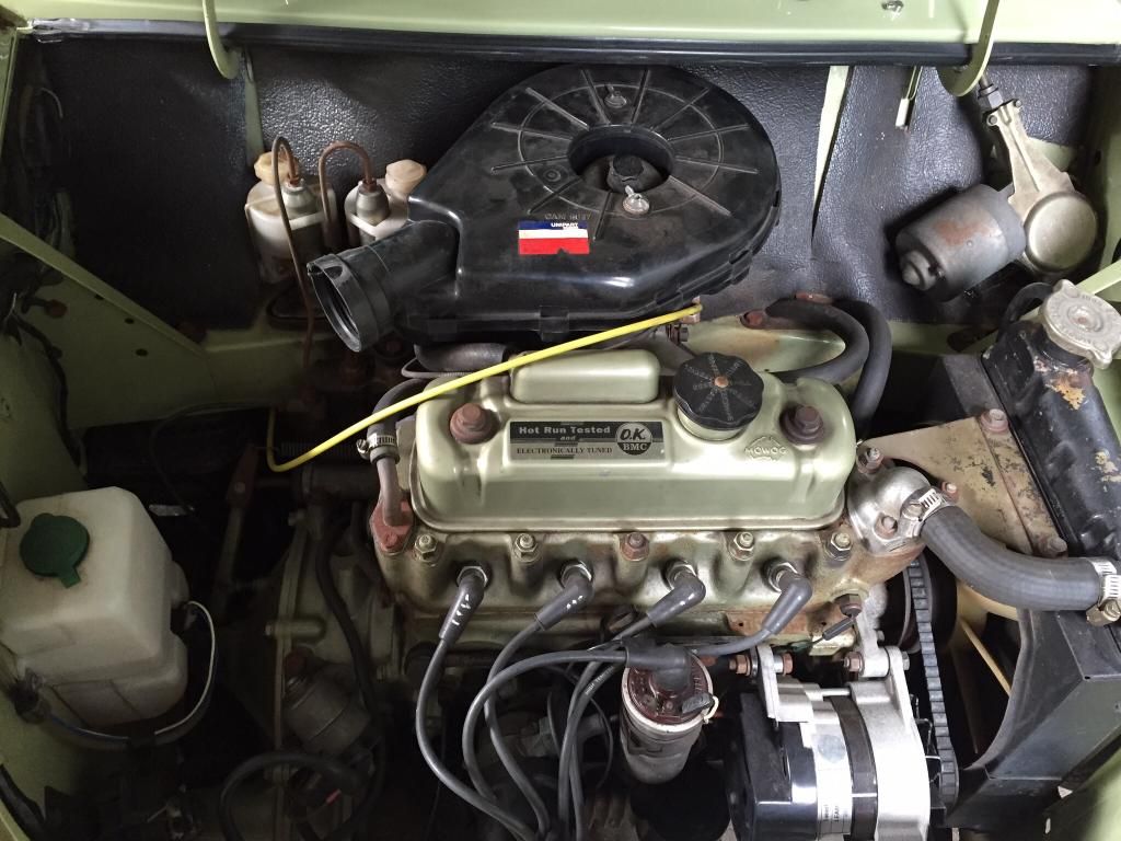

Currently I have the following air cleaner fitted and am hoping that fitting a Ramflow or K & N filter will have the engine breath a little better, any recommendations?
Current filter

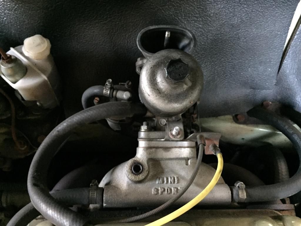

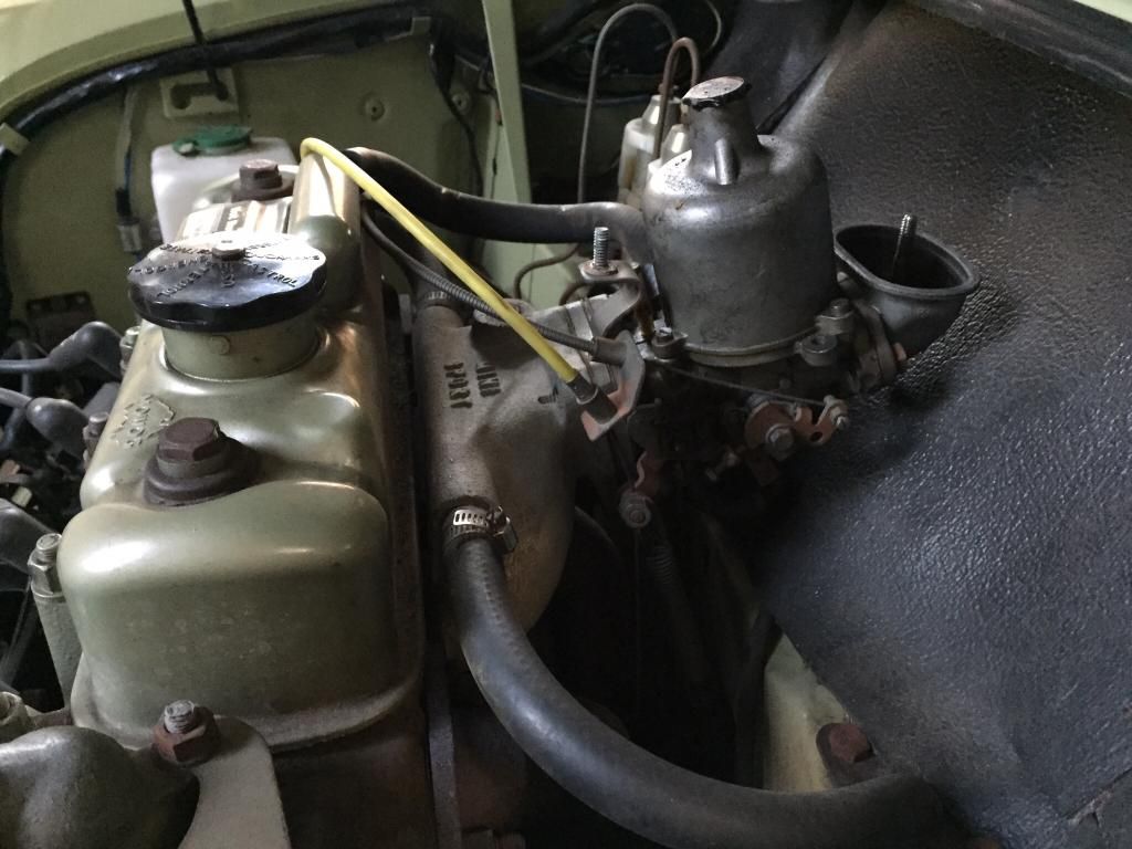

I'm not exactly sure what size Carby is fitted, is there an easy way to identify this?
It does have a mini sport inlet manifold, is this worth keeping or would changing to a different manifold/carby setup provide better performance?
I have only just bought this mini and it looks like it may have extractors fitted they look pretty small though so I will also be looking at a decent set of extractors.

Your carby is an 1-1/2" , should be ideal for your engine , as for the extractors , it would be a lot of work for minimal gain , depending on what the internals are of your engine , if it's a bog stocker , your not going to notice any difference , same with the air filter, you could change it to either one that you suggested for appearance , but don't expect it to throw you into the back seat when you put your boot into it :wink: .

spend your money getting it tuned properly as it is
PostPosted: Sun Feb 22, 2015 11:28 am
A sports filter will give more noise than that donut one, but no more power.
For explanation of this see http://www.calverst.com/c_corner.htm
PostPosted: Sun Feb 22, 2015 1:11 pm
Posts: 4501
Location: Wollongong, NSW
Here is a link to the test by KC. It suggests a KN filter in the standard box is better on a standard engine than a cone or pancake filter..

That is an HS4 carby, it is already bigger than the HS2 used on all 1098 Minis.
Twin HS2s go really well on a 1098, even a stocker- but if the motor is still stock inside, the HS4 you have is big enough if you are keeping a single.
If it has a cam and headwork already, THEN it's worth fitting either an HS6 or an HIF44 carby, on what you have or a better manifold.
Better = Russell Engineering RE7, the Minispares C-AHT770 one is much the same as what you have now. The RE7 needs a Weber box fitted to make room for any air filter.

If you get something like a minispares "Stage One Kit" with a 1 1/2" SU carb it can be a good place to start. Mine was about $450 delivered from the UK. With a good tune up you'd get a bit more power and a better noise too.

Bigger isn't always better. You can always fit a bigger carby, but it will bog down and ruin your torque at low rpm and *might* give you a little more at the top end. 1 1/2" is fine for a standard 1098, you would go up to 1 3/4" if it's more modified.
My order of attack would be:
A 'stage 1 kit' - new extractors, inlet exhaust, and air filter, same as what sako has now (if the extractors have been fitted, I presume the exhaust has been changed). You can modify the original air box by drilling holes around the sides and fitting a good quality filter. With a tune this should give you ~20% more power. Be sure to get it tuned by somebody who knows minis!
