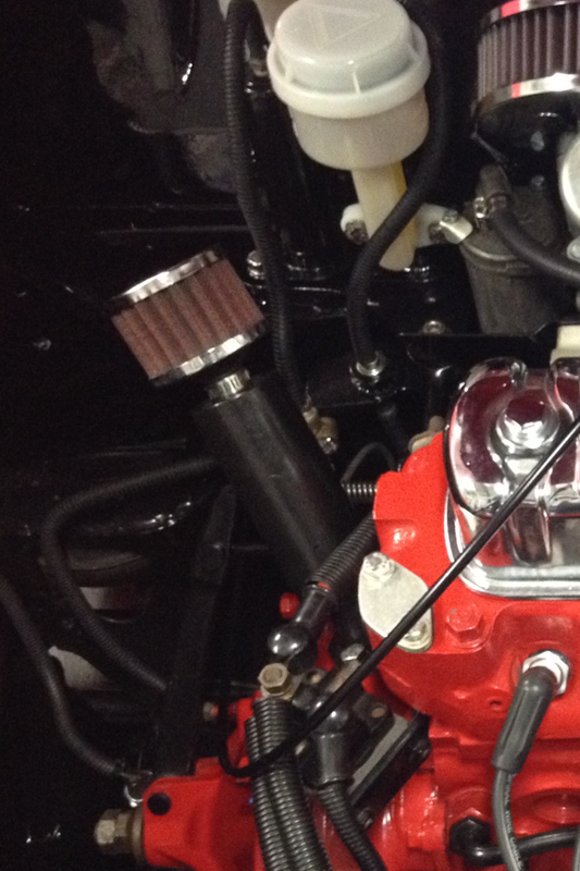

Hi Guys.Looking for some help re Crankcase ventilation.I have a new complete HS4 1& 1/2" SU carby kit including manifold linkages ect for my Cooper S.The manifold does not have a connection point for the existing PCV valve only an outlet for the vacumn to the brake booster.The 2 carbs have 2 points to connect a hose then to a Y piece & then I am assuming a single hose to the canister on the side cover.Is this all I need to do or do need a PCV valve in the single line after the Y piece?
Cheers Kath.

I thought that was the case.It appears that if you use the 2 carby inlets you dont need a PCV valve.I have run 2 hoses from each carb to a Y piece,then a single hose to the canister on the side cover.
Cheers Kath.

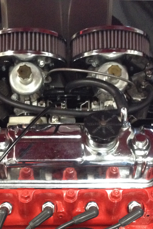

I went from the rocker cover to a T piece then to both my carbs....? Is this ok??
I've also got a breather on the clutch case
 Post subject: Re: pcv
PostPosted: Fri Mar 20, 2015 8:08 am
Hanra, you would be better to hook the clutch housing breather to the carbs. As a GT was. Sucking from the rocker cover can drag oil fumes out.
You should block the rocker vent or severely restrict it, as it is now you may have too much flow into the carby vac ports which can make it lean down low. Cooper S and 1100S had a breather cap, however I find it works fine with a sealed one too.
Having said this, the rocker cover vent works OK on my 1360 to a pcv valve in the manifold (with vented cap and no flywheel housing breather). :)
I think my rocker cover cap is a vent type also. I wonder how I could restrict the rocker cover port??
