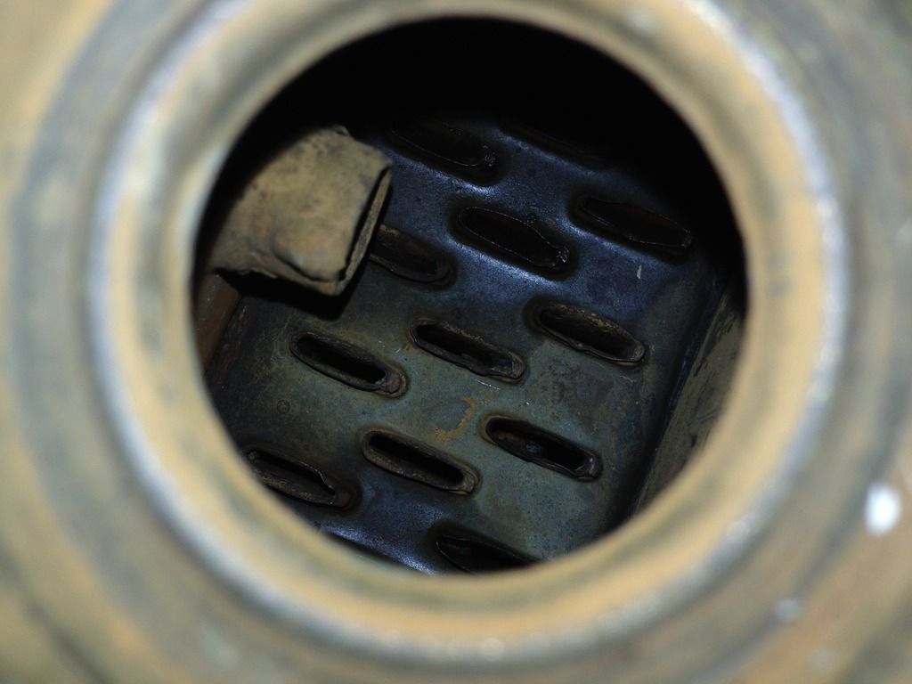

I recently had an overheating issue and was told that my radiator core needed replacing at an exorbitant fee.
I bought a new radiator and then had my old one left over.
This is a (poor) picture inside the radiator cap.
I thought I'd see how clean I could get it.
If Napisan can clean "mud" out of nappies I thought it might clean "mud" out of a radiator.
I mixed one scoop of Napisan with two litres of hot water and stirred to dissolve the powder.
Fitted radiator cap and layed the radiator flat and filled it up.
Left it for 24 hours and then flushed it out with the hose.
What it didn't remove was the rust flakes as these won't dissolve and they would have to be mechanically removed.
But the result I thought was pretty good.
Could do the same with heads and blocks.

 Post subject: Re: Radiator cleaning
PostPosted: Thu Apr 02, 2015 9:21 pm
Better to rod it out to be honest imho. The reason being that the little pieces of iron from the block, rubber from overuse of gasket goo, paper gasket etc etc will not be moved or dissolved by our puny chemicals in a lot of cases.
With so few tubes, the loss of one tube is a significant % of the total available cooling. It will not budge for love nor money with the low pressure of a hose, no matter how much froth and bubble you make, but it will dislodge with a piece of wire pushed through the core quite easily.
I would do this more at home if I had a pressure tester set up. I can solder and desolder the tanks quite easily, and butane torches with bottles are only around 35 dollars these days, but this is pointless if the tank is not tested for weeping or porous solder joints.
All the same it is not that expensive to have a radiator hot tanked, tanks desoldered, core rodded through, and then tank resoldered and pressure tested and painted black. Around 100 dollars.

Carefully use of caustic soda and a flush gun is about the best you can do with it in situ. Other than that it's a r 'n r job. Also don't forget to flush the block etc before refitting the rad, for obvious reasons. Might sound stupid but its amazing how many people, including workshops, who don't.
