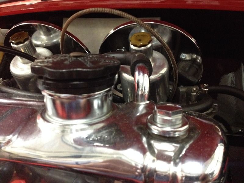

Im pretty sure Ive brought this topic up before in someone elses thread, but rather then hijack, Ill make my own.
OK first up..... Is my rocker cover oil cap a vented type? Is air drawn in or pushed out at this point? If it is pushed out, I guess I am also pushing air out of the tube/vent on the top of my Rocker Cover, which, via a hose and T piece, goes directly to both carbs.
I also have a breather fitted at the clutch end. It appears to push air out of that location. If air is being pushed out here and pushed out at the rocker cover...... at what point is air being drawn in????????
So.... Could I buy another Rocker Cover without the tube/vent pipe? Block off the two ports on both carbs? And not effect the crankcase ventilation??? I dont want to blow a seal out... I have no other breathers fitted......

Yes it's a breather cap. As used on Cooper S, Clubby GT, 1275LS and Morris 1100S. It is an air INLET.
That rocker cover is not an 1100S or Cooper S one. They are sealed. I have some here if you need one.
Normally there is a PCV valve on the manifold, and it's connected to that breather can on the flywheel housing for Positive Crankcase Ventilation. Air goes into the cap, and fumes + air out through the PCV valve, into the manifold.
On a road car, this stops smelly engine fumes getting into the cabin.

On a standard set up, what is connected to the two ports on either carb???
As you mentioned previously, having these ports directly connected to the rocker cover could be causing a lean condition?

Hanra wrote:
Thanks Doc. Cant say Ive ever had to much of an issue with fumes in the car with the current set up.
On a 1275LS, the breather can connects to the vac port on the carb.
On a late Clubby 998 the breather can (on the side cover) connects to the vac port on the carb. Air is drawn into the rocker cover via the charcoal canister. The rocker cover pipe is restricted by a tiny hole. Cap is sealed.
On a Clubby GT the breather can connects to BOTH vac ports on the carbs via a Y piece.

Ok thanks Doc. If I were to get another rocker cover without that vent/tube pipe. Keep my vented Rocker Cover cap on. Block off the ports on both carbs, keep the clutch case vent as it is, do you see any issues with crankcase breathing?

Posts: 39757
Personally, I prefer the original PCV system for a roadgoing 1275.
If you don't want to do that, I would bin the bling filter, block the carby vac ports and just run 2 hoses to a catch tank. Cap would be fine.
Those Bling breather filters have been known to block up.
