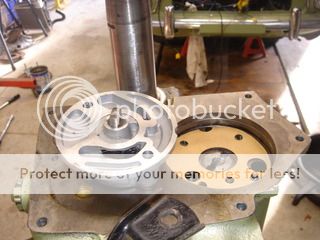

Whilst I had the pump off, I fitted an alloy plate to seal the gearbox casing up to the 1st motion shaft. Then I filled it with oil up to the top of the plate, stuck some plastic tube into the oil inlet port, and sucked oil up. NO bubbles. :) This proved there was no air leak at the O-ring on the sump flange. Sanded the pump chamfer, fitted a new gasket, all was good then.

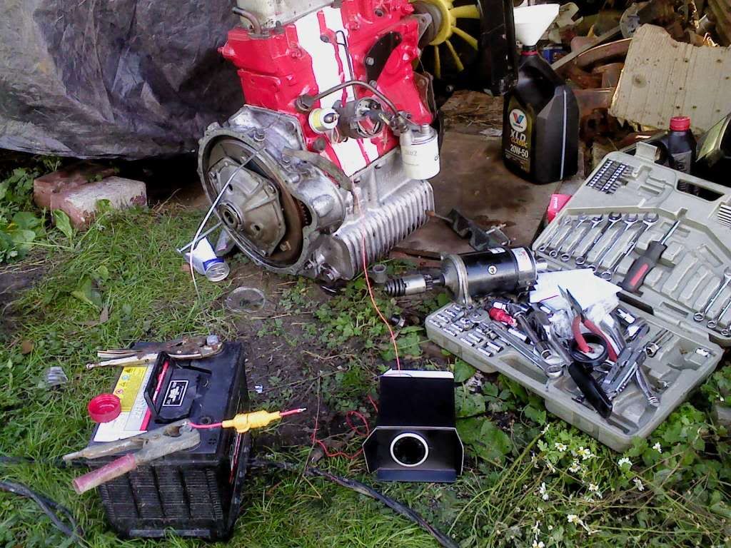

Always a good idea to test your oil pressure before putting the engine back in. I tested mine with an electric gauge, a battery and a bolt in the flywheel as a handle to crank the engine. A bit dodgy, but does the trick!

Looks like it to me. You need an alloy spacer, 6.5-7.0mm thick. With a gasket both sides.
See the info and pics I put up on Todd Miller's website-
http://www.austinamericausa.com/
Scroll down to technical advice >engine >Converting an Automatic Block to Manual Transmission Block:
You could make that into a garden diorama :)

If it does have a 998 one, grind a 45deg x 2mm chamfer on the pump body and refit it. Use some grease on the gasket. Then remove it and inspect the gasket for good marking.
[edit] I have to say, I have never seen a 1275 auto block get converted to manual without a spacer. Because the oil drilling usually comes through the corner, 1/2 in the spacer and 1/2 in the block.
If it is a 1275 manual pump in an auto block, it MUST have a spacer.
If the motor has never been run since assembly, I would pull the relief valve seat out and check the 2 holes have been blocked (see pic above). If these are not blocked, you will NOT have oil flow through the filter. The oil will go directly into the back of the main oil gallery instead. :(
